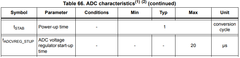

Just want to share that by injecting an additional delay in the initialization of the ADC, the error improved. The ADC init sequence becomes:
(1) Initialize
(2) >20us Delay (manually added)
(3) Calibrate
(4) Enable
(5) Convert
and it seems related to the ADC start-up time:
0693W00000bhT4kQAE.pngThough, this delay should be handled by the auto-generated code from STM32Cube.
Any experience with this? Is it normal to add a delay? How do you determine the needed delay?
or any material that may explain the delay needed before the ADC calibration? tia
waclawek.jan
The ADC startup procedure is described in ADC Deep-power-down mode (DEEPPWD) and ADC voltage regulator (ADVREGEN) subchapter of ADC chapter in RM. It refers to the delay given in datasheet, as er the screenshot you've posted.
I would expect it does affect the calibration; however, I don't know why would that affect only one pin's reading, though, nor why would that be different from powerup. Maybe this all depends on some minute details of your particular application.
Maybe it is. I don't use Cube, but it's open source so you can look it up easily.
MarlonM
Been using ADC channels: ADC1, ADC2 and ADC3
Upon checking the other ADC channels being used, found out that the whole ADC3 channel was affected.
The code is being built on a lower version of STM32Cube (1.5.1) and the delay being used was 10us.
When compared to the latest version of STM32Cube, the delay is now 20us.
This might be a case of marginality issue.
Thanks JW!
