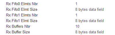

How about your receive buffers configuration?
there is no "Receive Buffer Configuration" in the IDE. How did you find it for the STM32G474?
I think there are 3 RX Buffers for the controller if I remember right, but I have no idea how to configure these and I have not found examples wher it is done.
Best Regards, Seppel
P.S. Nothing about RX-Buffers in the generated fdcan.c file.

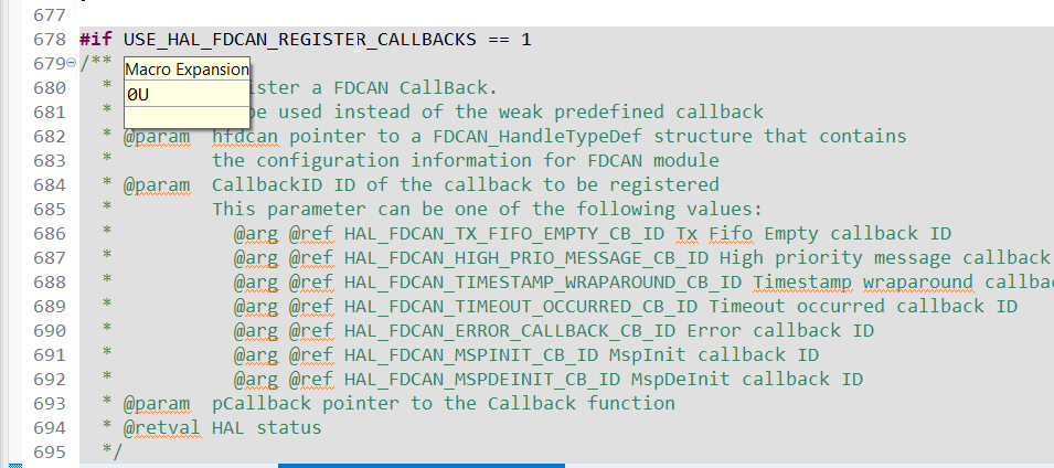

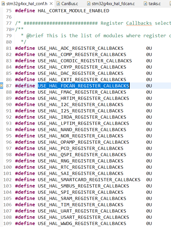

There is a presentation, but no examples and explaination on how that relates to the HAL-Functions/API : STM32G4-Peripheral-Flexible_Datarate_Controller_Area_Network_FDCAN.pdf
Interesting,...
If I remember correctly, this is only if you want to use callback(s) other than the default one already provided. You can leave this to 0, it will not prevent the callback function to be called when an RX IT is triggered.
The screenshot I took is for an F series MPU, but as far as FDCAN is concerned, this should be very similar to the Gs.
