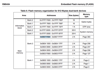

Hi everyone.
I caught a problem on STM32G0B0KET6. I want to write a data to main flash memory. But I detected that I can not  write any data page 382 and page 383. I only can not write to this pages. There are no problem for other pages.
For this pages, I always took error(warning) of FLASH->SR : CFGBSY after when I write first word that is 32 bits.
I spent to find for two day for this problem. If I did not test other pages, I would have lost time more. I used HAL library for this process.
Do you have any information about this problem?
Note: I write as Type of DoubleWord.
Thank you.
Best regards,
https://www.st.com/resource/en/reference_manual/rm0454-stm32g0x0-advanced-armbased-32bit-mcus-stmicroelectronics.pdf
Page number for following SS: 55

Hello @erkanc
Please check if the write protection error flag (WRPERR) of the FLASH_SR register is set.
Read 3.5.2 FLASH write protection (WRP) section in RM
I already tested it. If I write any data to page 382 and page 383, CFGBSY bit is stucted as set. But there is no problem for other pages.
Hello again @erkanc
Could share with us the sequence to write double word in these 2 pages
