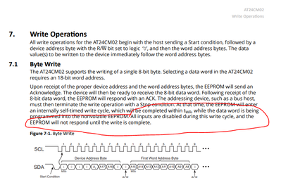

I checked while testing and found that
Writing to the first page (Device Address Byte's A17, A16 are 0,0) works normally.
However, when writing data to another page, an error code is output from the code.
However, the symptom that is confirmed at the same time is that when writing to the first page, both the clock signal and the data signal are confirmed when measuring SDA and SCL with an oscilloscope. However, when writing to another page, SDA only maintains a HIGH state and SCL only maintains a LOW state.

Perhaps you missed this part of the datasheet :
Write times depend on temperature and wear, so you might need to implement the "acknowledge polling" the datasheet suggests.
