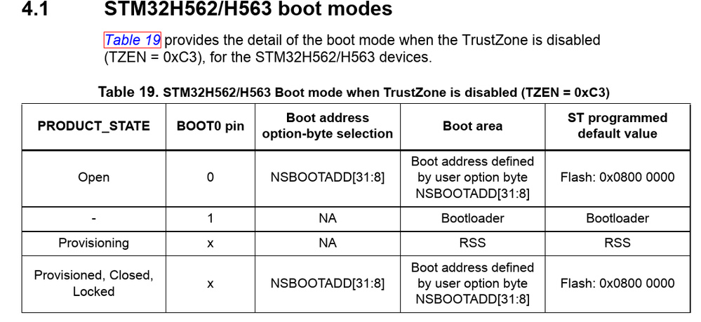

does STM32H562 have the system rom bootloader?
I cannot find it AN2606, however its datasheet does mention the system bootloader.
Thank you

reading rm0481 might help :
2024-05-08 11:27 AM
Thanks, yes this is the table I referred to in my original post. However, when I look at AN2606 it does not list STM32H562 as an option. So now I am not sure, is the reference manual wrong? Or AN2606? Or am I reading it wrong?

Hello @tommz9 and welcome to the ST Community 😊.
Thank you for reporting this. It is already reported to the concerned team to update the AN2606 ASAP (under internal ticket number 179001).

STM32H5 series: STM32H503xx, STM32H563xx, STM32H573xx, STM32H523xx, STM32H533xx
I'd wager they share the same die
The H562 lacks Ethernet, well at least that part of the core, and the IP costs associated with it are disabled / deducted.
