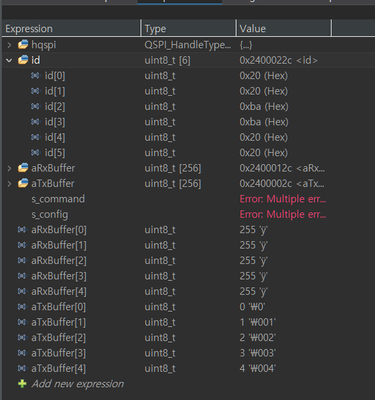

I am currently testing the MT25QL512ABB flash memory on an STM32H747I-DISCO board.
The board has two of these flash chips, and I am attempting to operate them in dual mode.
I am using the driver from the official STMicroelectronics repository available at this URL:
https://github.com/STMicroelectronics/stm32-mt25ql512abb
My test code is designed to do the following:
On the first boot, it writes data to a specific region of the flash.
It then immediately reads back the data from that same region to verify that the write operation was successful.
After a reboot, the code reads the same flash region again to ensure the data is still correct.
The initial write and immediate read-back verification works perfectly. However, after I reboot the board, the subsequent read operation fails. The data read from the flash does not match the data that was originally written.
I have already disabled all cache functions, so I don't believe this is a caching issue.
I am looking for advice on what could be causing this problem.
Thanks.

 int32_t flashStatus = MT25QL512ABB_OK;
 uint32_t test_state_flag = 0;
 /* 1. Enter QPI mode */
 flashStatus = MT25QL512ABB_EnterQPIMode(&hqspi);
 if(flashStatus != MT25QL512ABB_OK)
 Error_Handler();
 /* 2. Read ID and verify */
 flashStatus = MT25QL512ABB_ReadID(&hqspi, MT25QL512ABB_QPI_MODE, id, MT25QL512ABB_DUALFLASH_ENABLE);
 if((flashStatus != MT25QL512ABB_OK) || (id[0] != 0x20) || (id[1] != 0x20) || (id[2] != 0xBA) || (id[3] != 0xBA) || (id[4] != 0x20)
 || (id[5] != 0x20))
 Error_Handler();

eziya76
eziya76Best answer
August 16, 2025
The root cause of this issue was a misunderstanding of the erase operation.
When an erase is performed in dual mode, it clears an area twice the size of the actual library region.
Therefore, the addresses must be managed to account for this behavior. You can find the answer in the follow-up post
https://community.st.com/t5/stm32-mcus-products/stm32h747i-mt25ql512abb-blockerase-function-erases-previous/m-p/831109#M284197
4 replies

eziya76
eziya76Author
August 13, 2025
Thank you for your reply.
I believed that the suggested code needed to be executed during the reboot sequence, so I placed it after the QSPI initialization. However, an error occurred from the very first operation, MT25QL512ABB_EnterQPIMode().
While searching online, I found some libraries for the MT25TLxx series (though not specifically for the MT25QL512ABB) that use functions like Reset_Memory() and QSPI_DummyCyclesCfg(). I am now further investigating whether my issue might be caused by missing such configuration steps.
