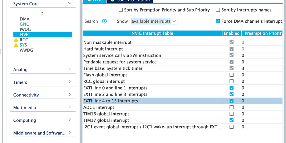

STM32G0 reseted after GPIO interrupt happened
Bigdan
I'm using gpio interrupt inside there
void HAL_GPIO_EXTI_Rising_Callback(uint16_t GPIO_Pin){
static uint32_t push_time;
if(GPIO_Pin == IS_FUSED_Pin){
pin_int_now = HAL_GetTick();
if(fuze_push_time + DEBOUNCE_INTERVAL < pin_int_now){
LED_Green_On();
fuze_push_time = pin_int_now;
state = FUSED;
Inside while(1) mostly HAL_Delay(5);
ISSUE: some times during pin interrupt happened chip looks like reseted.
Gess some error happened and chip reseted. How can debug it and find the reason?

MM..1
Chief III
From where you have this name for func and sure this can work, i mean not IRQ exist only once ...
  LED_Green_On();
  state = FUSED;
when interrupt is enabled , but not assign right handler result is reset MCU
But for G0 your code seems ok then debug app an place breakpoint in main before while on some init , when break repeats mcu was reset...

Bigdan
After hour of investigation found the issue but no idea why it happen and how it fix
Use PA7 as external interrupt source
Use PA11 for control p- channel mosfet transistor
When PA11 in low and trigger PA7 pin for interrupt chip reseted!(
When PA11 in hight and trigger PA7 pin for interrupt works good.
Bigdan
Actually find what going on.  Pin PA11 connected to switch with on push connect mosfet drain to ground chip power go dawn and reset happened.
If it some possibility on STM32G0 detect low power and in my case turn off mosfet?
In documentation can not find.

Bigdan
Solved the issue. Turn off PA11 mosfet pin inside interrupt handler before ship will go to reset.
Read: "masked hardware and software issues with quick-and-dirty fix". ;)
