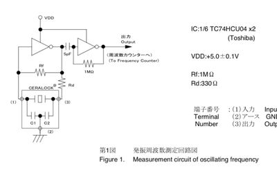

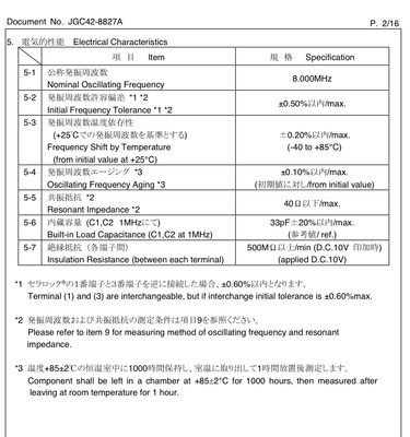

The datasheet suggests load of 20pF .
Due to size constraints, I hope to use https://jlcpcb.com/partdetail/318914-CSTNE8M00G550000R0/C341522
Most 8Mhz resonators of this size seems to have 33pF

Dear @pilot ,
Resonators are a bit different from Crystals as they have their built-in CL1 and CL2, this murata resonator has 33pF C1/C2 which is different from Crystal CL . In general CL1/CL2 value are in range of twice for crystal for the value of CL - Stray /Parasitic .
Here this resonator is fully compatible with STM32F1 series . You can use no worries.
You can also refer to our Application Note :
I’m interesting to know the end application usage, this resonator has 8MHz ( -/+ 0.5%) you can use built-in HSI .

For USB you want HSE
Also HSI+PLL gets you to 64 MHz on the F1
2024-11-03 9:09 AM
Ah, thank you - I knew about 64Mhz, but that is plenty enough, but the USB was a good point
2024-11-03 10:29 AM
For USB : System Clock should be either 72Mhz or 48MHz . A 8MHz crystal with 0,05% precision is a must . I’m not sure that the precision of the selected resonator is safe .
