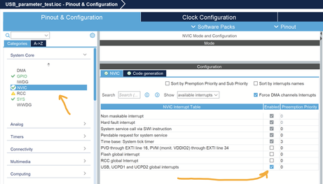

I used the default USB Settings (default USB STMCube MX generated).

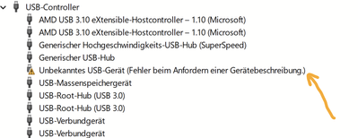

Then I open the Windows11 "Gerätemanager (Device Manger)" and the USB device always failed to get recognized.

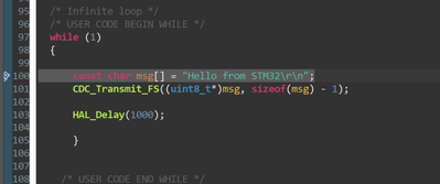

However when adding a debug breakpoint (for example in the while(1) loop) the STM32 gets no longer recognized as a COM device anymore.
Same problem as before:
So is this a bug? Or is it simply not possible to have a working STM32 COM-device when working with the debugger? Is this problem caused by the fact, that the USB works via Interrupt and interrupts fail in the debugger?
I don't think that's altogether unexpected?
By putting a breakpoint, you will disrupt the comms between the USB Host (your PC) - which could well cause the failure.
You have to be very careful about breakpoints withing timing-critical code!
It's not that they fail as such - but halting the core may cause deadlines to be missed.
This isn't specific to STM32 - it's an inherent limitation of halting debug.
