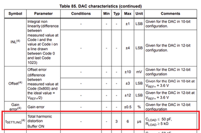

Hello @Junzhe and welcome to the ST community,
According to the datasheet, there is a tSETTTLING parameter: typical 3us / max 6us with the respect of the load characteritics (Buffer ON) as the following:
So "an ideal square wave" is something not reachable.
Hmm,
if the diagram is to scale and the timing okay, the edges look much wider than 6µs. So the load may be to high.
hth

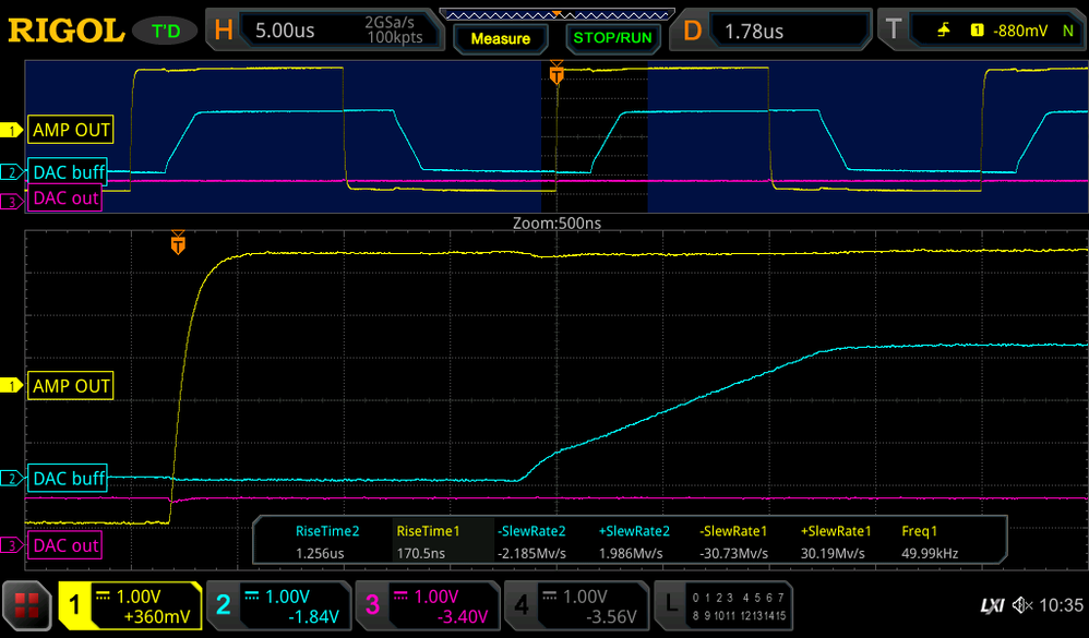

a) DAC with onboard buffer has slew rate about 2V/us (with negligible capacitive load).
b) Clarify how did you made your "scope trace" - it looks distorted
c) Consider using external buffer, then your rising and falling times can be up to ten times shorter (can be seen on following scope trace)
d) If you need realy sharp edges, consider using another method. Like DAC + analog switch etc.
Blue trace - Output directly from DAC (on board buffer)
Yellow trace - output by external buffer (LMH6612 there)

What is your powerlab (DAQ ?) specs ? In other words, does it have enought bandwidth and sampling frequency to capture microseconds rise times ? It looks like the DAC is fast as it should be and you're just observing it wrong.
