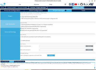

I'm running standalone STM32CubeMX on Debian and I'm having trouble generating a complete project. No matter what I do, code generation only produces three items:
- led_test.ioc
- Inc/ folder
- Src/ folder
I'm expecting a full project structure including Core/, Drivers/, startup files, and a .launch file for STM32CubeIDE.
Steps I've already tried:
1. Selected the NUCLEO-F334R8 from the Board Selector (not the MCU).
2. Clicked Yes to initialize all peripherals with default settings.

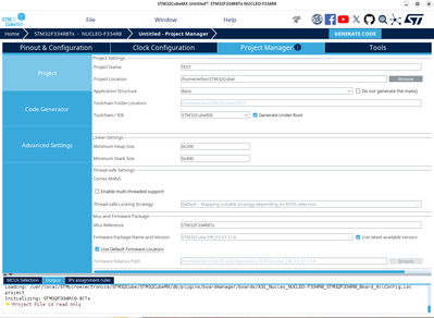

3. In the Project Manager tab, set the Toolchain / IDE to STM32CubeIDE before generating.
4. Clicked Generate Code — same incomplete output every time.
