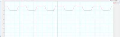

I want to generate a bipolar square wave with a pulse width of 100us per phase using the DAC in STM32F446RET6.
But when I measured the DAC output (PA4), I found that the DAC output was not an ideal square wave, but a trapezoidal shape with a long rise time. However, according to the STM32F446RET6 manual, the DAC conversion time should be only a few microseconds. I used the DMA function and triggered the DAC output via Timer 6, but there was no improvement. How can I make the DAC output as perfect as possible?

Hi Michal,
You are correct. I previously set the sampling rate to 20KSPS, so the minimum unit was 50us, which resulted in insufficient precision. I now increased the sampling rate to 200KSPS. I got this result:
The time required for the DAC to change is about 40us, which is still longer than the theoretical time in the data sheet. But I looked at your results and found that the change time was about 1.256us when no buffer was used. I connected my PA4 pins directly with my PowerLab.
What other possible reasons could cause my results to be inaccurate?

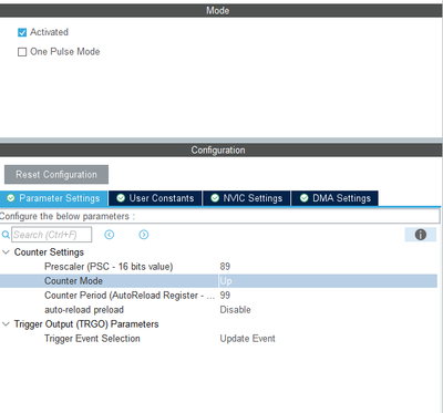

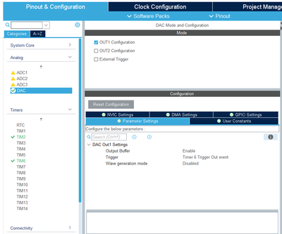

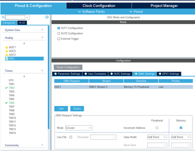

Also attached is my TIMER6, DAC settings and code.
uint16_t square_wave[2] = {
1861, // 1.5V
1241 // 1.0V
HAL_DAC_Start_DMA(&hdac, DAC_CHANNEL_1, (uint32_t*)square_wave, 2, DAC_ALIGN_12B_R);
HAL_TIM_Base_Start(&htim6);

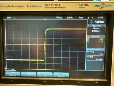

Hi Michal,
I replaced the Powerlab with an oscilloscope. You are right. From the oscilloscope, I can see that the rise time is only about 2.5us. Thank you very much for your analysis and answer!
