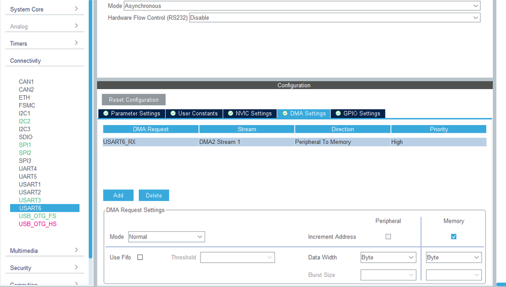

If you use DMA2 Stream1 for USART6 RX access, I guess you should have some code here in order to handle DMA2 Stream1 IRQ that will happen at end of reception.
Something like :
HAL_DMA_IRQHandler(&hdma_usart6_rx);
The handler is enabled in MX_DMA_init function:
static void MX_DMA_Init(void)
  /* DMA controller clock enable */
  __HAL_RCC_DMA1_CLK_ENABLE();
  __HAL_RCC_DMA2_CLK_ENABLE();
  /* DMA interrupt init */
  /* DMA1_Stream1_IRQn interrupt configuration */
  HAL_NVIC_SetPriority(DMA1_Stream1_IRQn, 0, 0);
  HAL_NVIC_EnableIRQ(DMA1_Stream1_IRQn);
  /* DMA2_Stream1_IRQn interrupt configuration */
  HAL_NVIC_SetPriority(DMA2_Stream1_IRQn, 0, 0);
  HAL_NVIC_EnableIRQ(DMA2_Stream1_IRQn);
So I only need to handle specific errors inside the DMA IRQ handler?

Sorry, I was not clear enough.
If you generate your project using CubeMx, I would have expected seeing following code in your stm32...xx_it.c file (where IRQ handlers are implemented). Goal is to map IRQ to their HAL handlers. For DMA2_Stream1 case :
void DMA2_Stream1_IRQHandler (void)
  /* USER CODE BEGIN DMA2_Stream1_IRQn 0 */
  /* USER CODE END DMA2_Stream1_IRQn 0 */
  /* USER CODE BEGIN DMA2_Stream1_IRQn 1 */
  /* USER CODE END DMA2_Stream1_IRQn 1 */
Hope it is more clear ;)

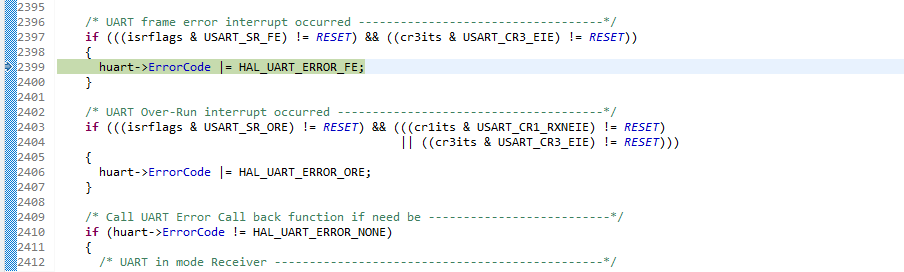

I have put a breakpoint on:
HAL_UART_IRQHandler
And I can see that the following error happends when I am sending the data:
