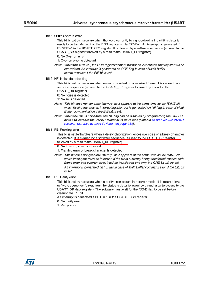

I have found out why this framing error happens. The USART6 lines are connected to another microcontroller UART( ESP32 ) . Another device starts up after STM32 is already started and initialised. When my another device starts up, it is initializing its own USART which causes the USART state to change during the initialisation hence the error occurs. When this error happens, the USART stops working.
I have made an experiment where I power both device at the same time using 1 power supply for both devices and the communication works as expected!
Can someone suggest me a way to clear this flag because for my application, my device that is sending the commands to the STM32 will always power up later than the STM32 itself. When my ESP32 device initialises it will cause this error to happen but I need a way to clear it so the USART still works.

But I cannot find any documentation or information on how this error can be cleared. I have looked at various STM32 documentations but I was not able to find one where UART is documented in detail

I have tried as suggested by this documentation:

After doing this. I cannot believe but the communication now works without any issues. When my ESP32 microcontroller starts, it causes the STM32 USART to go into the Frame error state but I read the SR and DR registers and it clears itself. After that, I can communicate between 2 devices without any issues!
Guenael Cadier
If the FE flag just occurs once, due to other initialisations impacting RX line, you could also try to call the macro for resetting FE flag, just prior starting your reception (i.e. prior calling HAL_UARTEx_ReceiveToIdle_DMA(&huart6,aRxBuffer6, RXBUFFERSIZE);
=> See __HAL_UART_CLEAR_FEFLAG(__HANDLE__) in hal_uart.h
(does basically what you added into your IRQ handler).
