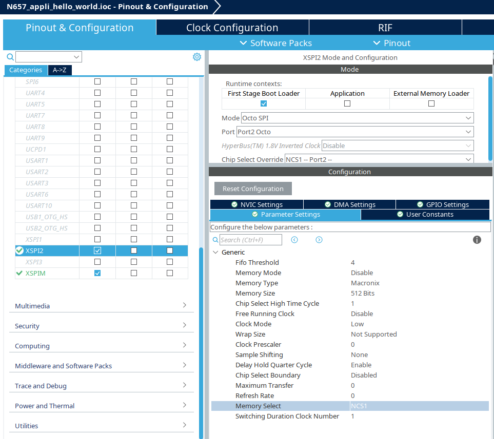

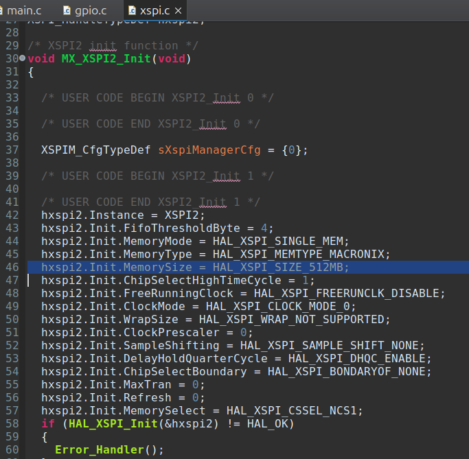

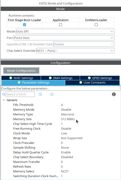

2.2.1 Configure the XSPI and XSPIM
Using the same STM32CubeMX project, locate the [XSPIM] under the [Connectivity] menu on the left and select it to run during the [FSBL] and have the [Direct] mode selected:
The OCTOSPI flash memory has the following characteristics: 1 Gbit, 1.8 V, 200 MHz, DTR, read while writing. It is connected to the OCTOSPI interface of the STM32N657X0H3Q microcontroller on the STM32N6570-DK board on XSPI2. With that information, go to XSPI2 to configure the peripheral according to the hardware available:
As for the [Parameter Settings], look carefully at the image below:

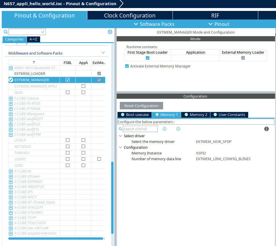

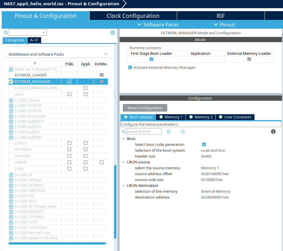

2.2.2 Configure the EXTMEM_MANAGER
The next step is locating the [Middleware and Software Packs] in the [Categories]. Expand the [EXTMEM_MANAGER]. Add the FSBL and activate it using the following settings:
[LRUN source address offset] =  0x00100000
[LRUN source code size] =  0x10000
[LRUN destination address] =  0x34000000
In the [Memory 1] tab, ensure its as follows:

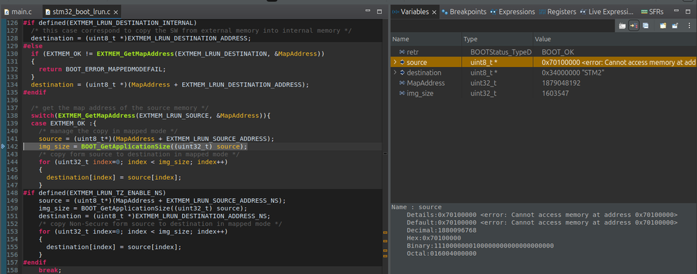

asdfasdf
Feb 19, 2025 1:09 PM UTC
Hi @B.Montanari ! Thanks a lot for this informative tutorial! Would you mind attaching the resulting project to the article, and also the known-to-work binaries (FSBL and Appli, ideally both signed and without header)?
I followed your guide but the Appli binary seems to not boot, and having these files would help me (and probably others as well) debug the issue.
Thanks, Michael

I had the same problem as the OP where the Appli binary wouldn't boot. Upon comparing the code shared by Bruno on Github I noticed the clock for IC3 in XSPI2 was set to 32MHz instead of 50MHz as per this guide. Once I set it to 32MHz and re-built, the Apply binary successfully booted. This change looks to have also made the clock solver to adjust other clocks as well, albeit to different values than what is in the Github repo.
asdfasdf
Feb 27, 2025 7:48 AM UTC
@flexiglass In my case the problem wasn't the XSPI2 clock (that works for me at 50 MHz as in the tutorial), but the SYSB clock (which feeds the AXI). I had this running at 400 MHz whereas @B.Montanari uses just 64 MHz. Lowering SYSB to 64 MHz made it work for me, and it also continues to work even if I increase the CPU clock (SYSA) to 600 MHz.
I have no idea why it is so sensitive to the SYSB clock, as that should not really have to do anything with the external flash I guess? I have the exact same problem when doing XIP instead of LRUN and asked about it here, sadly without an answer so far. This is pretty disappointing, as the MCU is dead-slow with RAM running at just 64 MHz...
