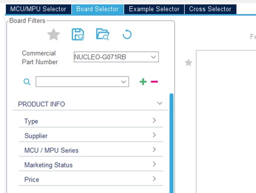

2. Project setup
1. Open STM32CubeIDE and create a new project by going to [File] → [New] → [STM32 Project]

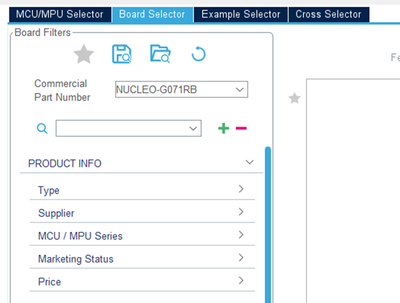

2. Select the board that you’ll be using. For this project, we use the NUCLEO-G071RB.

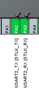

3. To start this project, we’ll use the default configurations set up by STM32CubeIDE. Note that the UART pins are on PA2 and PA3.

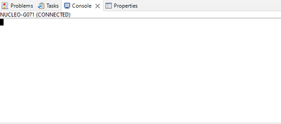

5. Open your serial monitoring console within STM32CubeIDE and connect your Nucleo board. Make sure you set the correct baud rate. If you initialized your STM32CubeIDE project with the default settings, it will be 115200. Here you can enter a character from your keyboard to interface with UART.
You will notice that the LED doesn’t start to toggle until the device receives a character, which is echoed back through the terminal. This demonstrates the inefficiency of using the HAL_UART_Receive function for UART communication.

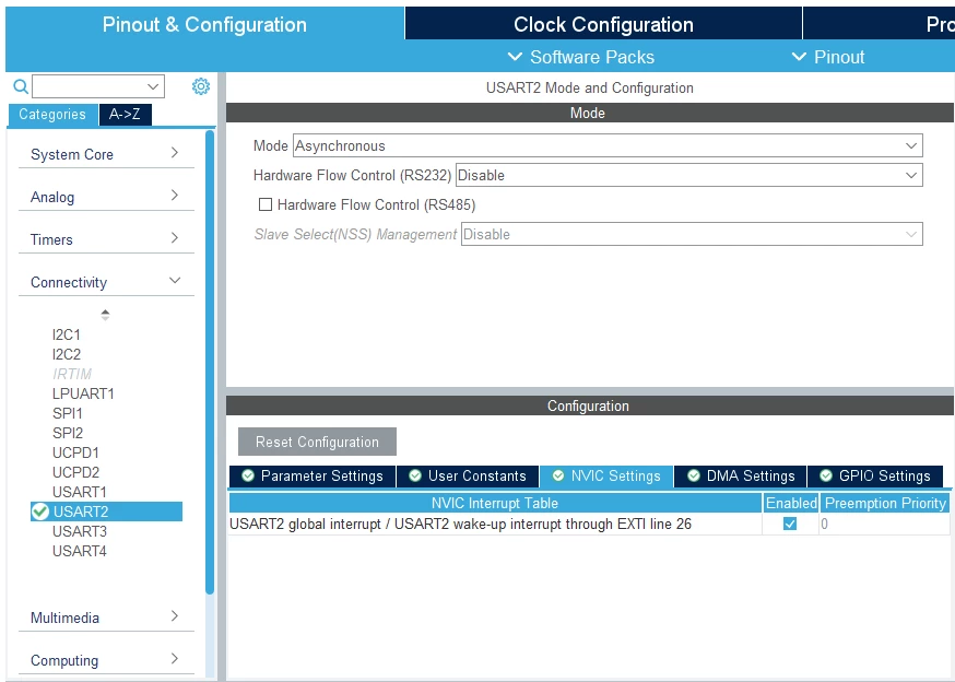

1. Enable the UART interrupt in the [Pinout & Configuration] tab of your .ioc file

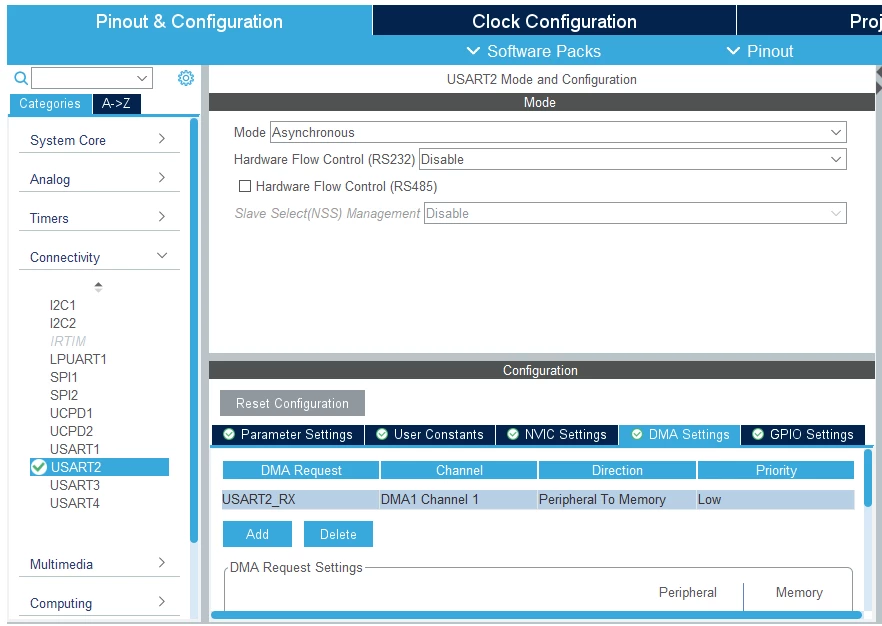

5. HAL_UART_RECEIVE_DMA
HAL_UART_RECEIVE_DMA is a non-blocking function that can be used for the UART receive functionality. This function works similarly to the HAL_UART_RECEIVE_IT function above, but it uses DMA to transfer the data instead of utilizing the CPU. This is particularly useful when you’re transferring large amounts of data.
2. Add a DMA Channel for UART Rx under the [Pinout & Configuration] tab of the .ioc file
3. Add the UART buffer initialization under /* USER CODE BEGIN PV */
uint8_t buffer[1];
/* USER CODE END PV */
4. Add the initial HAL_UART_Receive_DMA call under /* USER CODE BEGIN 2 */
 HAL_UART_Receive_DMA(&huart2, buffer, 1);
 /* USER CODE END 2 */
5. Add the HAL_GPIO_TogglePin command and HAL_Delay under /* USER CODE BEGIN WHILE*/
/* USER CODE BEGIN WHILE */
 while (1)
	HAL_GPIO_TogglePin(GPIOA, GPIO_PIN_5);
	HAL_Delay(100);
/* USER CODE END WHILE */
6. Add the interrupt callback under /* USER CODE BEGIN 4*/
/* USER CODE BEGIN 4 */
void HAL_UART_RxCpltCallback(UART_HandleTypeDef *huart){
	 HAL_UART_Transmit(&huart2, buffer, 1, 0xFFFF);
/* USER CODE END 4 */
7. Build and run your program.
8. Open your serial monitoring console within STM32CubeIDE and connect your Nucleo board. Make sure you set the correct baud rate. If you initialized your STM32CubeIDE project with the default settings, it will be 115200. Here you can enter a character from your keyboard to interface with UART.
As you can see through this example, using a DMA channel functions similarly to using an interrupt. The LED will toggle the entire time and isn’t blocked by the UART receive being incomplete.

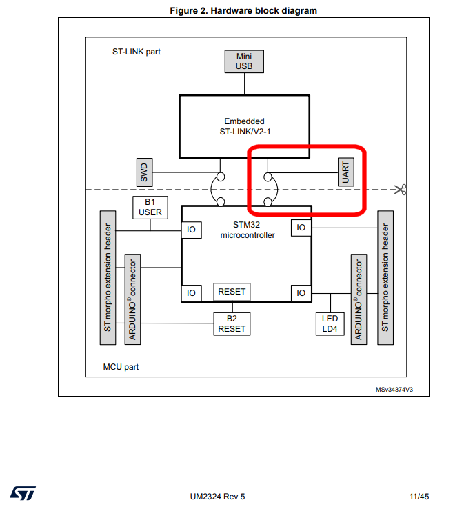

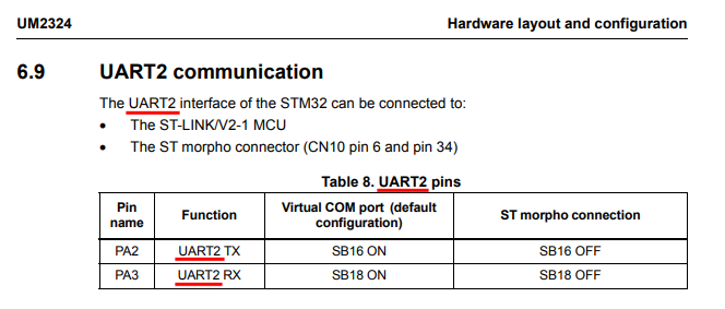

TL;DR: If you are using a board other than the NUCLEO-G071RB, be sure to check which U(S)ART to use for that particular board - it may be different !
Detail:
This example refers specifically to the NUCLEO-G071RB, and uses the Virtual COM Port (VCP) of that board's ST-Link for the UART communication with the PC:
On the Nucleo-G071RB, the UART used for this is UART2:
If you are using a different board, be sure to check which UART (or USART) is connected to the VCP!
You can check in the User Manual for the board - it will be on the 'Documents' tab of the board's Product Page.
See also the board's schematics - which will be on the 'CAD Resources' tab of the Product Page.
