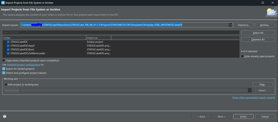

3.1 Step 1: Open STM32CubeIDE
  • Click in [File][Open Projects from File System…]
  • Add the path to the [Import source], ensure that all projects are present, [Finish]

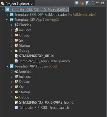

3.2
Step 2: Project setup
  • After this, a group of three projects should appear in your IDE. This example will focus on the FSBL (bootloader) and AppS (application). The ExtMemLoader's main purpose is to provide a custom external loader file. Although this is optional, since the STM32CubeProgrammer already includes a functional *.stldr file for the Discovery kit:

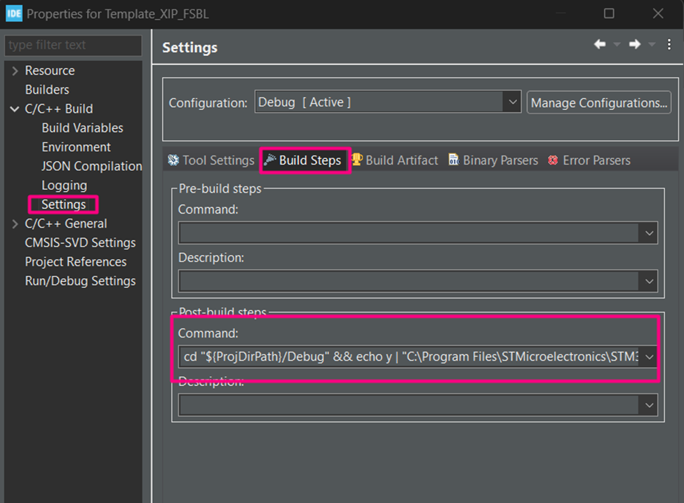

3.3 Step 3: Add post build step and Build All
  • As described in here, it’s possible to add the postscript to sign the binaries. In short, we can add this post build command for the [FSBL] and [AppS] projects. Starting from STM32CubeProgrammer version 2.21.0, a new parameter is needed at the end "-align". Please make sure you use the updated command, as follows:
cd "${ProjDirPath}/Debug" && echo y | "C:\Program Files\STMicroelectronics\STM32Cube\STM32CubeProgrammer\bin\STM32_SigningTool_CLI.exe" -bin "${ProjName}.bin" -nk -of 0x80000000 -t fsbl -o "${ProjName}-Trusted.bin" -hv 2.3 -dump "${ProjName}-Trusted.bin" -align

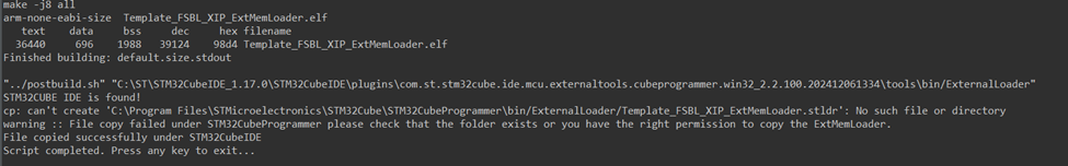

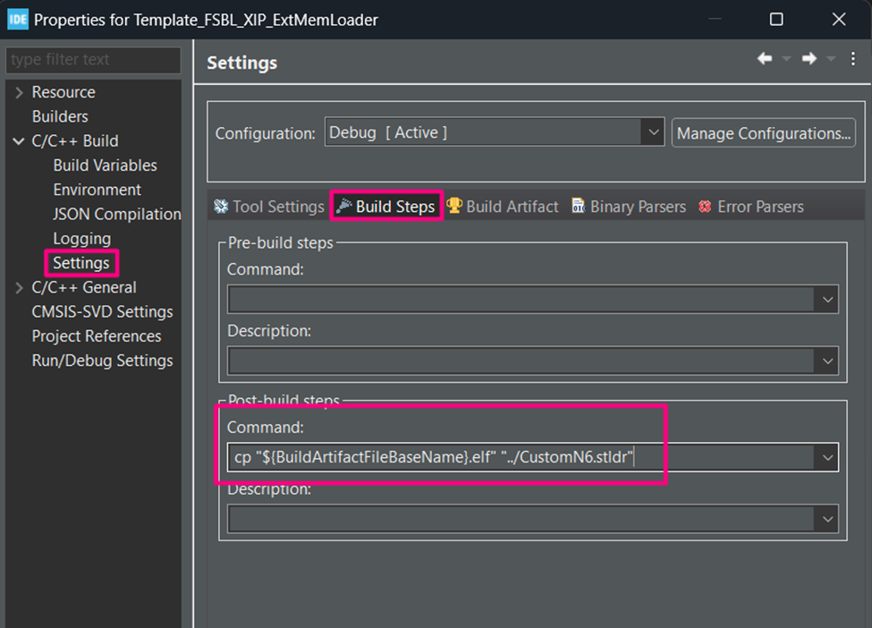

  • Known limitation: the current post build script for the ExtMemLoader might require admin rights to include the *.stldr file, in case you see this message:
  • It’s possible to replace the post build with this command:
cp "${BuildArtifactFileBaseName}.elf" "../CustomN6.stldr”
  • Which will create the CustomN6.stldr file within the project folder:

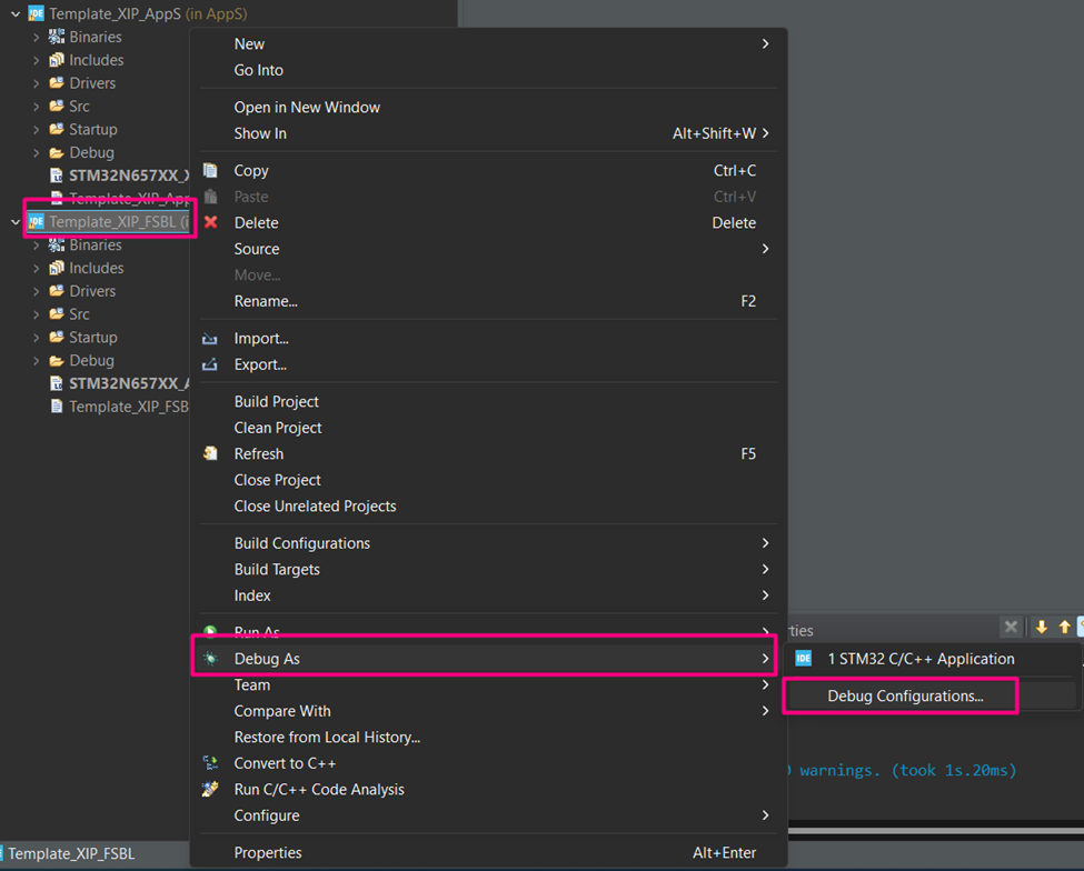

  • Configure the Debugger to write both applications and run them in the same session. Right-click on [Template_XIP_FSBL] and then [Debug As] -> [Debug Configurations...]:

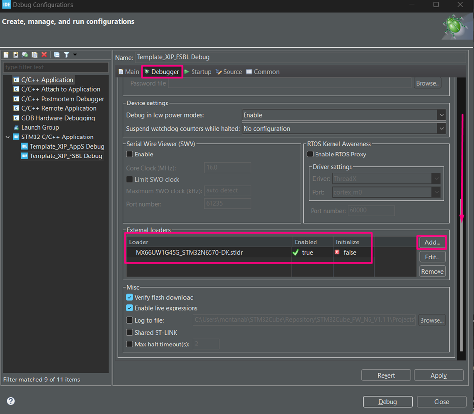

  • In the [Debug Configurations] window, go to the [Debugger] tab. Then, [Add] the following external loader MX66UW1G45G_STM32N6570-DK.stldr:
  • Check [Enabled] and uncheck [Initialize].

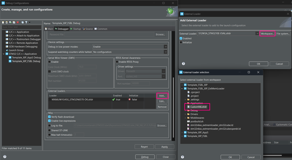

  • It’s possible to use the CustomN6.stldr instead. For that, in the [External loader] window, select the [Workspace...] and locate the CustomN6.stldr:

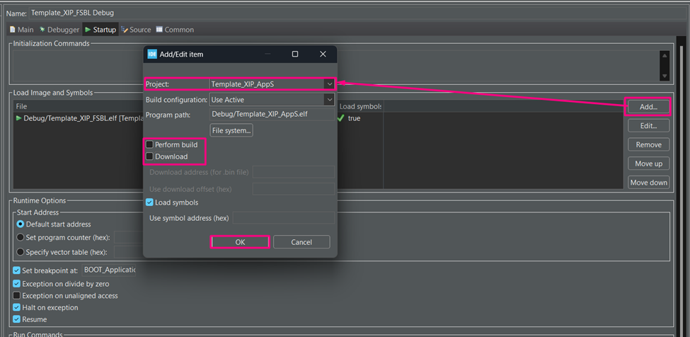

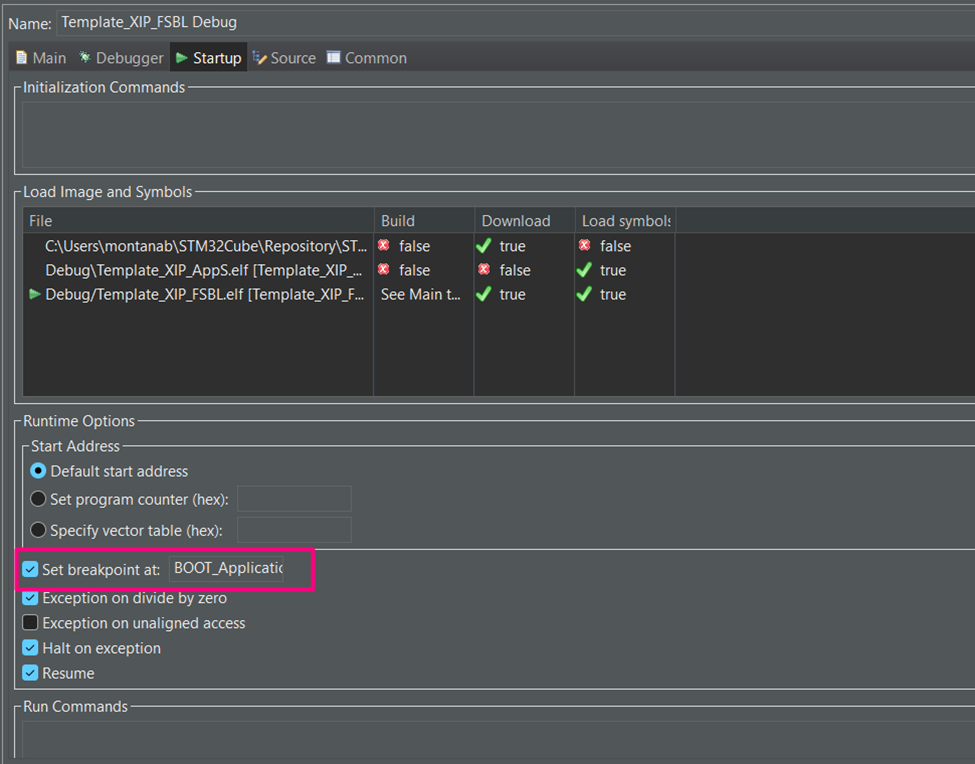

Step 5: Startup configuration

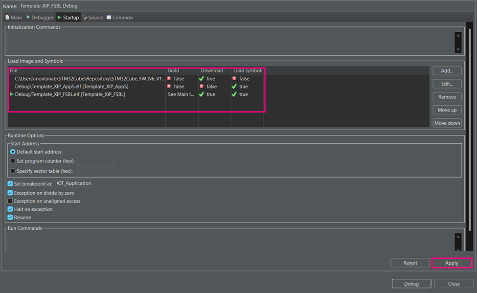

  • Go to the [Startup] tab and add the AppS project. Make sure to uncheck the [Perform build] and [Download]:

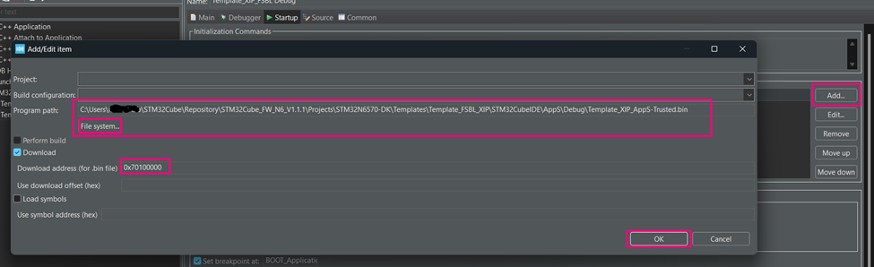

  • To program the AppS in the external serial FLASH, click on [Add...] and point to the signed binary. It will be available in the Debug folder with the project’s name-Trusted.bin. Make sure to add the address pointing to the external memory as well 0x70100000:
C:\Users\%username%\STM32Cube\Repository\STM32Cube_FW_N6_V1.1.1\Projects\STM32N6570-DK\Templates\Template_FSBL_XIP\STM32CubeIDE\AppS\Debug\Template_XIP_AppS-Trusted.bin

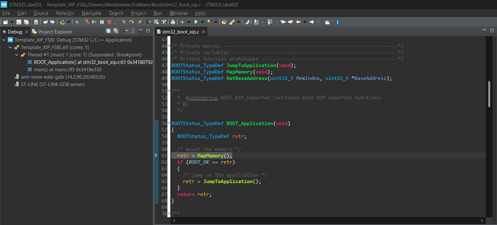

  • Due to the limitation of placing breakpoints, we'll set the first breakpoint in the FSBL function call BOOT_Application instead of the usual main. Now, in the FSBL firmware, the XSPI has the external memory configured in memory-mapped mode:
  • The final view should be like this:
  • Click [Apply] and [Close]. Configuration and the debug are now ready to run.

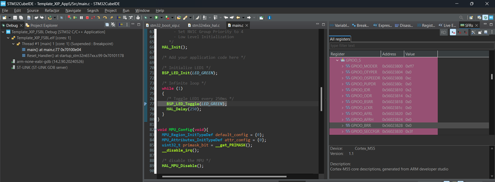

3.7 Step 7: Start debugging
  • Connect the board to the computer and click [Debug] in the IDE. If all steps were completed successfully, running the application should halt at the breakpoint set in the BOOT_Application function:
  • The code starts in the FSBL application running from an address within AXISRAM2. After the code stops here, press [Resume]. The green LED should start blinking on the board.
  • By pausing the code, it's possible to notice it's running from the external flash. This can be verified by examining the function addresses in the call stack. At this point, it’s possible to utilize all standard debug features. These features include breakpoints, variables, registers, and memory views.

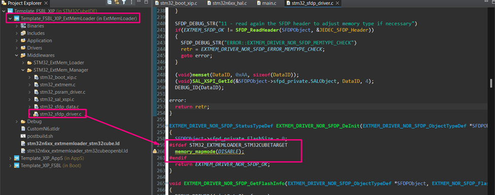

An error message may occur when you enter debug mode with the external memory preprogrammed. If this happens, power cycle the board (disconnect and reconnect it to the computer). This is due to a small error in the default *.stldr provided, which will be corrected on future releases. To avoid this problem, it’s possible to add these lines in the stm32_sfdp_driver.c, function EXTMEM_DRIVER_NOR_SFDP_DeInit:
#ifdef STM32_EXTMEMLOADER_STM32CUBETARGET
 memory_mapmode(DISABLE);
#endif
Rebuild the ExtMemLoader and use the CustomN6.stldr instead.

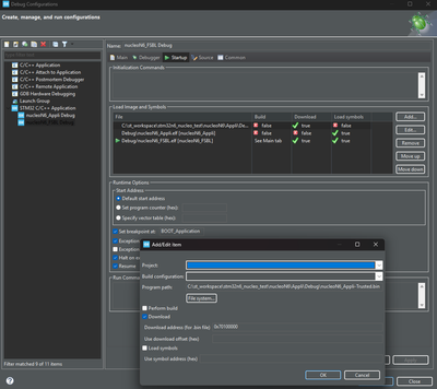

Jul 4, 2025 12:37 AM UTC
Hello @B.Montanari,
I created a project using only FSBL+Appli without using extmem loader. I configured everything up to the “Startup” stage similarly to what is shown here.
When I press the Debug button, the code is loaded to the external flash, and I can actually test the blink code in “appli” by setting a breakpoint. However, despite these settings, I am getting the following error:
Break at address “0x18003a1a” with no debug information available, or outside of program code.
What could be the cause of this, or can you suggest a solution?
Note: I have attached a screenshot of my debug settings.
