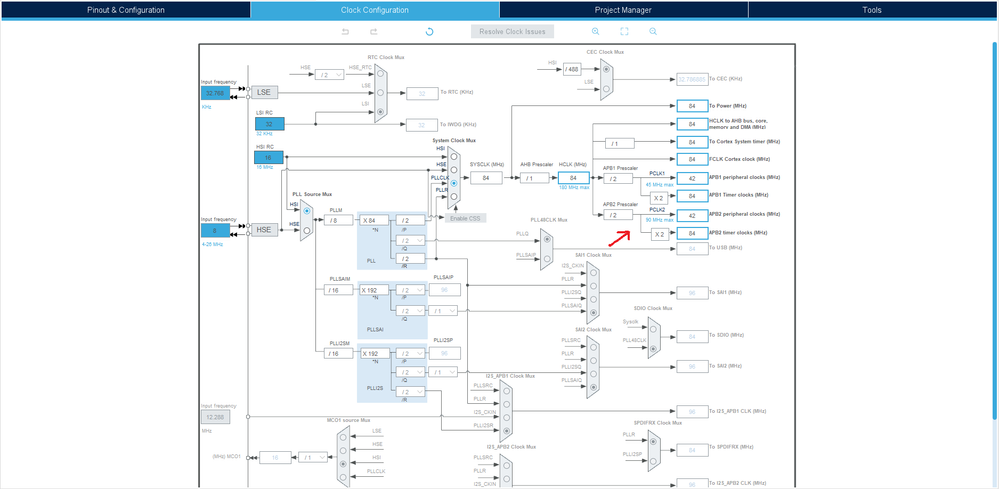

I have the Nucleo - STM32F446RE board and have been trying to work with the PWM (using CubeMX) on it for Motor Control. But for some reason I was getting 32.8Khz whenever I set it for 32Khz (while SYSCLK was 180Mhz). I checked my calculations but to no avail. Finally I realized that when I set it to 84Mhz, I got the accurate 32Khz frequency I wanted. Upon further inspection if I kept the SYSCLK as 84, APB2 prescaler as /2 and *2 again for the APB2 timers, the problem returned. I realized that it may not have been about just the SYSCLK but the prescalers too. A /2 *2 configuration caused the 32.8Khz and a /1 *1 configuration resolved it (for 84 Mhz), but I can't do the same for 180Mhz as the clock after the first prescaler is supplied to APB2 peripherals and has a max of 90Mhz, so it can only work with a /2. This board is actually an upgrade to another M4 board I ran on 80Mhz and found to be insufficient for my use so I was looking forward to the 180Mhz. Is there any way I can solve this and get both, 180Mhz and accurate PWM? I have pasted the code and clock tab below if it can help.

HSI is unprecise and PLL influences it - see footnote under the HSI parameters table in the latest datasheet.
‎2021-06-19 11:19 PM
‎2021-06-20 2:24 AM
The Period value needs to be encoded as N-1
84,000,000 / 2183 = 38479.157
84,000,000/ 32000 = 2625
htim5.Init.Period = 2625-1;
sConfigOC.Pulse = 1312; or 1313 would be approximately 50/50 duty
‎2021-06-20 3:21 AM
I dont understand you example code (5364 result to ~15k), maybe your setup have some fail .
But when you need perfect freq, you need HSE or thermal corrected calibrate HSI table.
Simple calculation if error HSI is +3% then your 32k changes to 32,96k
‎2021-06-20 10:02 PM
Yes the 5364 was just me tying out different values to check if the problem was at that specific range of frequency, sorry I forgot to update. As you all suggested I fixed the problem by using HSE and and am now getting the desired 32 Khz. Thanks
