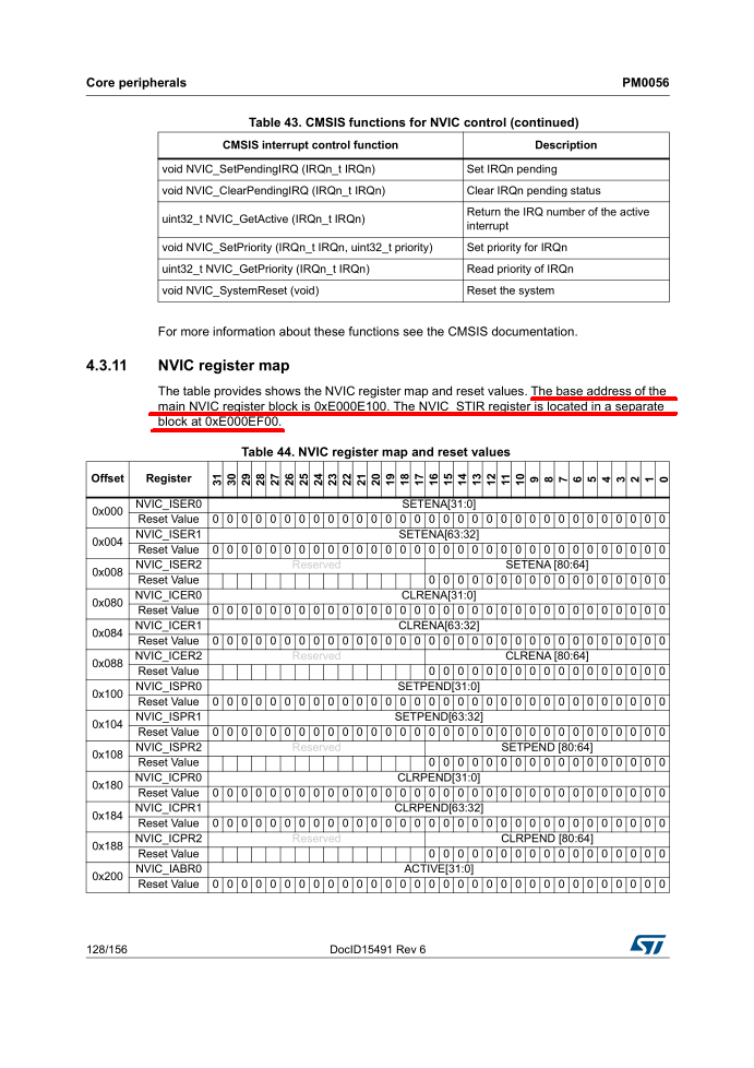

PM0056, Rev 6, page 105, Table 33. STM32 core peripheral register regions,
Nested vectored interrupt controller;
twice ?
0xE000E100-0xE000E4EF Nested vectored interrupt controller
0xE000EF00-0xE000EF03 Nested vectored interrupt controller

Hello @placidity.master_gmail.com​,
As already answer by @Community member, the block address of the main NVIC register (ISER, ICER, ISPR ICPR IABR and IPR) is 0xE000E100-0xE000E4EF.
The NVIC_STIR register is located in a separate block at 0xE000EF00.​
