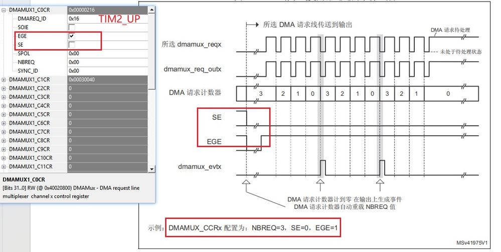

Background: The timers TIM12/LPTIM1/2/3 used by DMAMUX1/2 to generate synchronization/trigger signals for H7 peripherals are all 16-bit, resulting in low precision. To improve precision and facilitate jitter compensation (testing shows a deviation of approximately 0.3ms–0.5ms per second), I intend to use the internal 32-bit timer peripheral TIM2.
The entire chain is divided into two parts:
Part 1: DMAMUX1-CH0, using direct mode (without any synchronization signal), maps the TIM2_UP event to HAL_DMAMUX1_SYNC_DMAMUX1_CH0_EVT.
Part 2: DMAMUX1-CH1, using synchronization trigger mode , uses HAL_DMAMUX1_SYNC_DMAMUX1_CH0_EVT as the synchronization signal to trigger UART4_TX.
My current test involves modifying the original LPTIM2-triggered UART periodic output routine by changing HAL_DMAMUX1_SYNC_LPTIM2_OUT to HAL_DMAMUX1_SYNC_DMAMUX1_CH0_EVT. At present, I can only observe that Timer 2 is running normally, but the UART does not output signals periodically. Since events are cleared by hardware, it is difficult for me to observe whether HAL_DMAMUX1_SYNC_DMAMUX1_CH0_EVT is effectively generated for further troubleshooting. Therefore, I am seeking assistance.
After reviewing the manual, the register status and event generation timing diagram appear to be the same.
Key code is as follows:
uint8_t UART_BUF1[]="1:hello world\r\n";
uint8_t UART_BUF2[]="2:hello world\r\n";
HAL_DMAEx_MultiBufferStart(&hdma_uart4_tx, UART_BUF1, &huart4.Instance->TDR, UART_BUF2,sizeof(UART_BUF1));
	ATOMIC_SET_BIT(huart4.Instance->CR3, USART_CR3_DMAT);
	HAL_LPTIM_Counter_Start(&hlptim2,37500-1);
	HAL_TIM_Base_Start(&htim2);
	HAL_TIM_PWM_Start(&htim2,TIM_CHANNEL_1);
	HAL_TIM_PWM_Start(&htim2,TIM_CHANNEL_3);

    pSyncConfig.SyncSignalID = HAL_DMAMUX1_SYNC_EXTI0;
    pSyncConfig.SyncPolarity = HAL_DMAMUX_SYNC_NO_EVENT;
    pSyncConfig.SyncEnable = DISABLE;
    pSyncConfig.EventEnable = ENABLE;
    pSyncConfig.RequestNumber = 1;
    if (HAL_DMAEx_ConfigMuxSync(&hdma_tim2_up, &pSyncConfig) != HAL_OK)
      Error_Handler();
    __HAL_LINKDMA(tim_baseHandle,hdma[TIM_DMA_ID_UPDATE],hdma_tim2_up);
  /* USER CODE BEGIN TIM2_MspInit 1 */
//	SET_BIT(DMAMUX1_Channel0->CCR,DMAMUX_CxCR_SYNC_ID_1 | DMAMUX_CxCR_SYNC_ID_2);
//	SET_BIT(DMAMUX1_Channel0->CCR,DMAMUX_CxCR_SPOL_0);
//	SET_BIT(DMAMUX1_Channel0->CCR,DMAMUX_CxCR_SE);
//	SET_BIT(DMAMUX1_Channel0->CCR,DMAMUX_CxCR_SOIE);
		SET_BIT(DMAMUX1_Channel0->CCR,DMAMUX_CxCR_EGE);
  /* USER CODE END TIM2_MspInit 1 */
