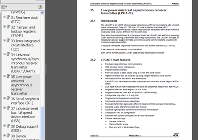

22. RM0503 bookmarks:
      35 Low-power universal asynchronous receiver transmitter
      To be like the other sections, should be:
      35 Low-power universal asynchronous receiver transmitter (LPUART)
23. RM0503 page 249: Missing IWDG bit in SYSCFG_ITLINE0 register.

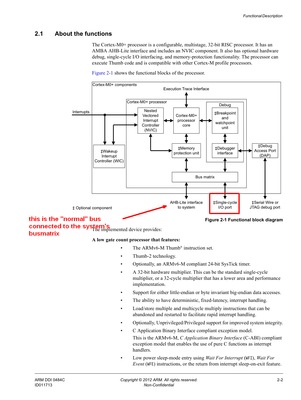

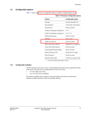

> 9. RM0503 page 56, figure 2: It is missing IOPORT address. See STM32G0 RM.
While true that it's not there, its not material, as IOPORT is not used in 'U0, in contrast to 'G0 (thus e.g. enabling DMA to GPIOs).
14, what a typo! :)
IOPORT is GPIO and so it is used in 'U0'.
waclawek.jan
No, IOPORT here refers to a private bus of the processor, exposed as a separate bus, not accessible from rest of the system. The processor itself decodes the 0x5000'0000 addresses to it.
In 'U0, apparently, ST decided not to implement IOPORT, thus the 0x5000'0000 address is decoded to the system bus, where in the bus-matrix it's connected to the GPIOs.
But you can try yourself: try DMA to some of the GPIO in both 'G0 and 'U0.
I updated the post and removed this item.

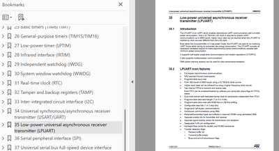

For the name on the bookmarks, it seems to be fine on my side:
Internal ticket number: 227745 (This is an internal tracking number and is not accessible or usable by customers).   Thank you for your contribution in STCommunity.
Kaouthar
The name on the bookmarks is fine on your side, but not on my side and I also have the Rev. 4
It seems you have other copy of the RM0503.
The name on the bookmarks, is just a detail and I only talked about it because there are other issues.
waclawek.jan
Can't the bookmark thing be artefact or your pdf viewer?  (I do see the "(LPUART)" in mine).
Can you try to widen the bookmark pane?
I opened the PDF with other PDF viewer and the name ends with (LPUART).
Thanks.
