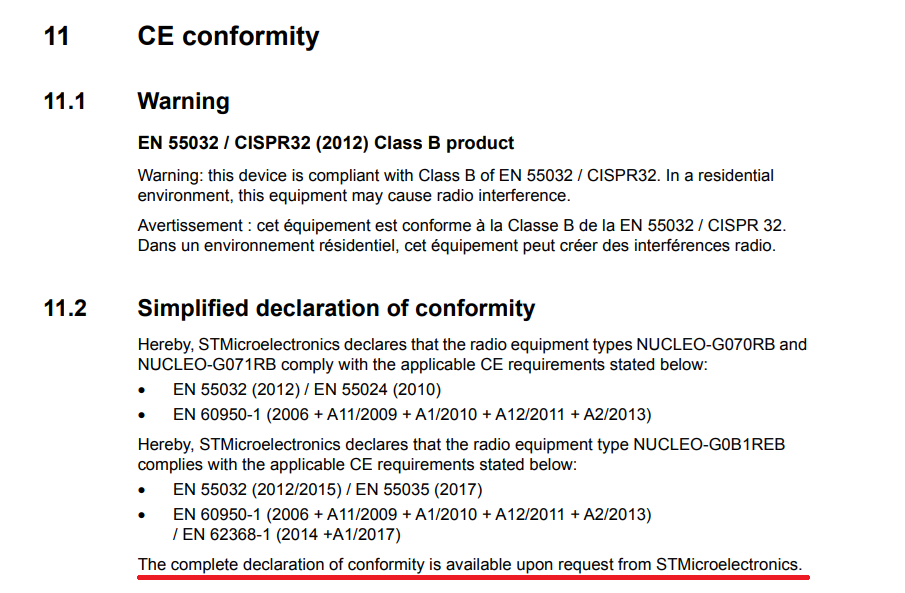

Hello @yz_89 and welcome to the ST community,
I don't think there is a CE conformity for the MCU itself but CE conformity is available for their ST boards.
Example: STM32 Nucleo-64 boards (NUCLEO-G070RB, NUCLEO-G071RB), the CE conformity is provided in the user manual of the board section 11 CE conformity:
It states that the complete declaration of conformity is available upon request from ST. The community channel is not intended to provide a such detail. So if this is not what you are looking for or you need more details, I suggest to contact your local sales or FAE or submit an online support ticket over this link: https://ols.st.com/
