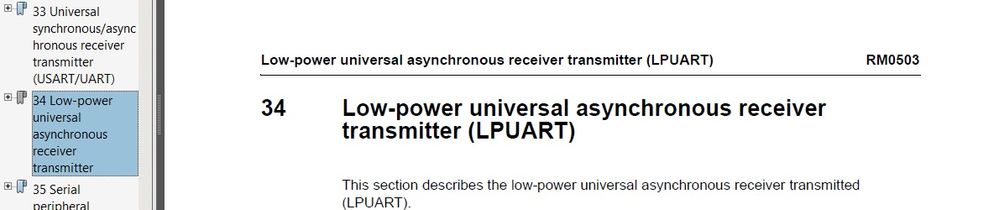

4. Usually each section name ends with an abbreviated name in parenthesis. Ex: Low-power universal asynchronous receiver transmitter (LPUART). And this abbreviated name is also in bookmarks on the left size of each RM. But (LPUART) is not in bookmarks in several RM possible all from the beginning.

Thank you so much for your contribution. I will report this internally for modifications on the next releases for the three first points. For the last point, can you give more explanation.

The blue text on the left should also end with (LPUART). I know this is insignificant and I just talked about this because I wrote this post due to other things.

I saw this in Rev 2 from 2024-03-26 and I believe this is the last revision. And as I told, the same is in several other RMs.
I think you don't understand. The problem is only the section name in bookmarks and not the section in the doc. The section "34 Low-power universal asynchronous receiver transmitter (LPUART)" is in Rev. 2 of the doc. The section name in bookmarks is: "34 Low-power universal asynchronous receiver transmitter". And should be: "34 Low-power universal asynchronous receiver transmitter (LPUART)" to be like the others.
Thank you so much, i will report this too.
Best Regards.
