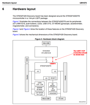

@mƎALLEm wrote:
From the user manual of the board
@mƎALLEm  This is another case where the Hardware block diagram (Fig 2) in the UM could be more helpful:
https://community.st.com/t5/stm32-mcus-boards-and-hardware/nucleo-user-manuals-don-t-show-the-vcp-uart-connection/td-p/644955
Already mentioned in the User manual of the board:
waclawek.jan
Is this a new board?
Because older revisions (B01) of it did not have the VCP capability.
Revision should be displayed on a sticker on the bottom of the board.
Yes, but it would be more helpful if it were also shown in the block diagram.
I guess that's why it's not shown on the block diagram - it was just copied without being updated?
