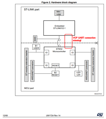

Nucleo User Manuals don't show the VCP UART connection
Andrew Neil
eg, UM2179 STM32 Nucleo-144 boards (MB1312):
Related:
https://community.st.com/t5/stm32-mcus-products/printf-causes-terminal-to-stay-just-empty/m-p/644954/highlight/true#M236811
@mƎALLEm
10 REPLIES 10
Andrew Neil
Also UM1724 for the Nucleo-64s:
Andrew Neil

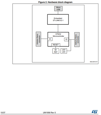

UM1956 (Nucleo-32) just doesn't label the connection at all:

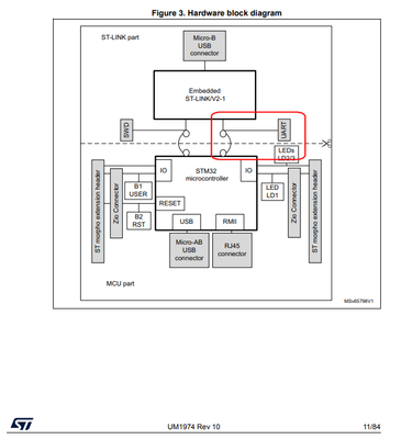

But UM1974 for Nucleo-144 boards (MB1137) does show it!
