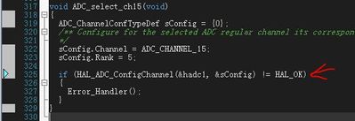

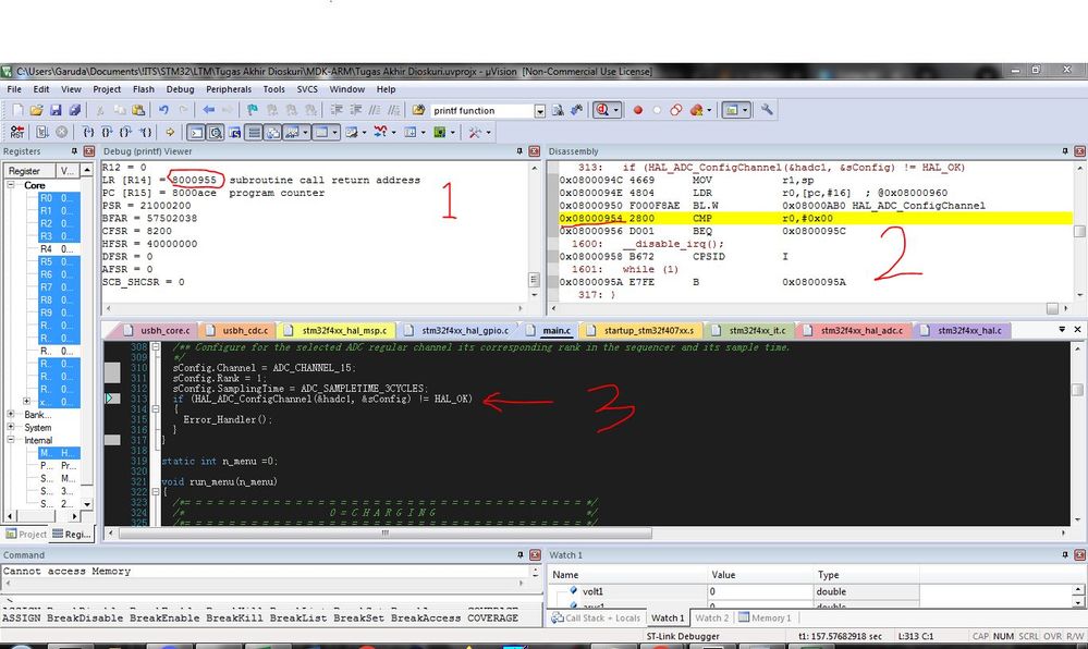

After reading a blog about HardFault analyzer, i managed to tweak my code and get the info about on which line i got stuck, including the LR and PC (showed by number 1 in the pic, top left). Turns out it is faulting when it is checking whether HAL_OK is TRUE in the main.c (number 3 in the pic, bottom).
The LR (call return address) has the adress 0x08000955 whis is not listed in the dissasembly (number 2 in the pic, top right)
I think the bad LR address might be the problem, i.e. reffering to the non-exist address in disassembly, note that in disassembly window (number 2) there is no address 0x8000955 after 0x08000954, but it goes straight to 0x8000956 instead.
But i am not really sure about it. Also, if thats the case then i would need group member's suggestion on how to deal with the fault. So i dont really know how what to do in this situation. Could anyone please help me?

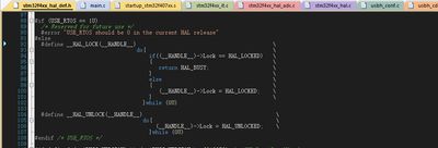

I had some trouble with HAL getting locked which send me to the Hal_Locked instance
But, I changed the Hal_Locked function so it can unlock itself in stm32f4xx_hal_def.h.
heres the Hal_locked function
HARDFAULT KONTOL1.JPGThanks in advance!
The address is actually 0x08000954. (Clear the lowest bit. this is because of thumb instruction set  TL;DR)

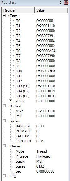

Inconveniently you truncate the register display in the screen shot.
Problem is likely with one of the parameters / structures passed to HAL_ADC_ConfigChannel()
More registers, denser display

Line of code
Registers:

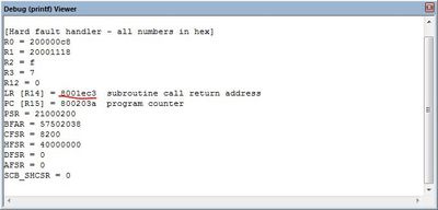

full printf debug window:

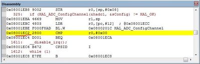

Disassembly window:

> LR address doesnt exist
As @Pavel A. said, [in your head] mask the LR LSB (set it to 0) to get 0x8001ec2 AS THE RETURN ADDRESS.
But LR is not what you should be paying attention to.  Look at the PC value 0x8000203a, THAT is where the problem was.  As @Tesla DeLorean said, it is probably an issue with the configuration structure you pass (0 in some field that expects a non-zero value, perhaps).
You're interested in the code that faults, not the return address for the last function call.
The fault is likely somewhere in HAL_ADC_ConfigChannel() when you use the parameters / pointers passed in. Probably &hadc1
Suggest if you have printf() working, that a) you print out the pointer "%p", b) dump out the structure, and c) the pointer for hadc->Instance
