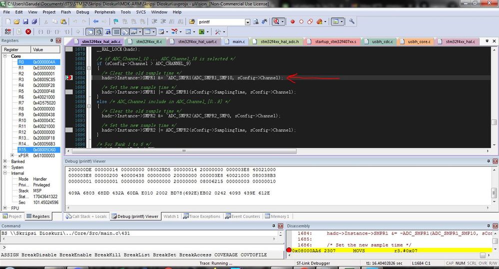

Thank you for your advices i just got the time to do it today. So i have changed the ADC from STM32CUBEMX all over again following my old reference, and i changed the HardFault handler to the one which is more dense. I retrace the Hard Fault and find that the code faults exactly at this code here which i supposed is for changing the sampling time(?)
Heres the clearer code (its on the clear old sample time)

and here is the Hardfault printf output
[Hard Fault]
r0 = 200000D8, r1 = 20000FA8, r2 = 00000001, r3 = 00000007
r4 = 00000000, r5 = 4D575020, r6 = 40021000, sp = 20000F48
r12= 00000000, lr = 080038B3, pc = 08000AD6, psr= 81000200
bfar=4D575030, cfsr=00008200, hfsr=40000000, dfsr=00000003, afsr=00000000
00000309 080065E8 20000F90 20000F88 08005C7B 20000000 200002EC 00000000
200000DE 00000014 00000000 08002BD5 00000014 20000000 000003E8 40021000
000003E8 00000200 40000438 00000000 20000000 000003E8 40021000 080038B3
00000001 00000001 00000000 00000000 20000000 08006215 00000003 00000010
409A 6803 68DD 432A 60DA E010 2002 BD78(692E)EB02 0242 4093 439E 612E
So now do i put the print %p and dump before that code line?
