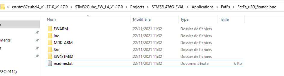

Hi SofLit,
After unzip the folder 'en.stm32cubel4_v1-17-0_v1.17.0.zip' an when I open 'STM32CubeL4 under \Projects\STM32L476G-EVAL\Applications\FatFs\FatFs_uSD_Standalone' that you that you mentioned
0693W00000GYPDMQA5.pngI have several folder in this directory and which one I have to take to read with Notepad ++ ? Thank for your helps.
Regards
mƎALLEm
  • Application source files are located under Src and Inc.
  • The drivers are located under \Drivers folder
  • FatFs middleware source files are located under \Middlewares\Third_Party\FatFS
  • EWARM, MDK-ARM and SW4STM32 are the IDE projects of the application for respectively IAR, Keil and systemworkbench
Hope it's clear ..
I open the fles source and It's work ! Thank you
