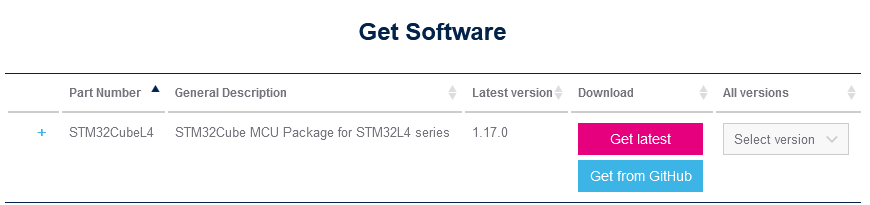

You can download STM32CubeL4 from this link.
Thank you, but It's mean I must install a software STM32CubeL4 ? I have a PC dedicated for STM32 development but which will arrive later (currently shortage) and I don't want to install the STM32 software on my current computer (risk of conflict with existing software). Can I view only the code under Notepad ++ for example (to understand the code first) ?
You don't have to install anything to just view the code. The package is provided in .c/.h/.s files.
Just download the package and unzip it.

DYann.1
Senior II
This one ?
Yes.
