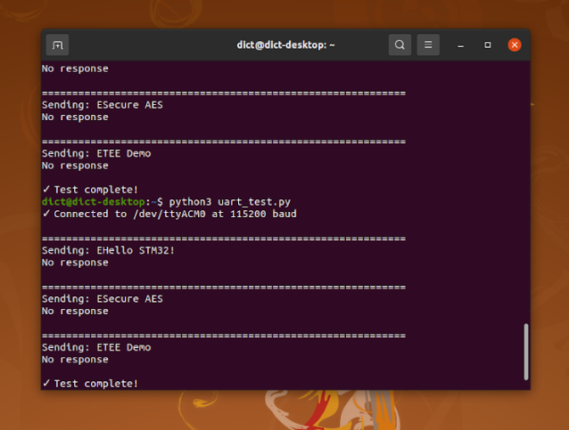

I am working with TEE, and my goal is to send plaintext from the reComputer to the STM32L5 so that it can be encrypted on the device. However, when I send data, I do not receive any response.
I have tried using both the USB port and ST-Link, but the result is the same. I can see the ST-Link device on the reComputer, but when I use USB CDC, it is not recognized.

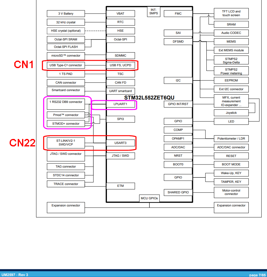

The connection (CN22) of STLINK over a virtual comport (windows)  offers a kind of "UART protocol over USB".
If you need to use the USB you need to use CN1 connector (USB FS).

As @mƎALLEm said, the ST-Link provides a Virtual COM Port (VCP); for native USB, you would use CN1.
For the VCP, you just need to use the STM32L5 UART on whichever of the STM32L5's pins is connected to the VCP - see the board's User Manual for details.

With ST-Link, the reComputer can detect it correctly, but I cannot send any data to stm32l5 and receive a response. However, when I use the CN1 USB FS port, although the cable is connected, the reComputer does not enumerate any USB CDC device from the STM32L5, so I cannot send commands or data.
