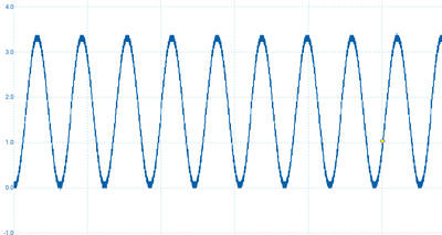

Initial state where a 127 uint16_t sample sin wave is transmitted over UART to the MCU, and is outputted to the DAC

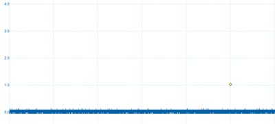

The interrupt is retriggered and the frame: AA 00 00 00 01 is sent containing length and frame rate of 0, and no payload, resulting in no hard fault, and stopping output from the DAC

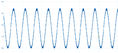

and then returning to the sin wave
