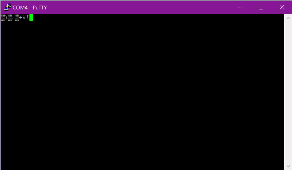

And this is what I am seeing in the PuTTY Terminal with one button press:

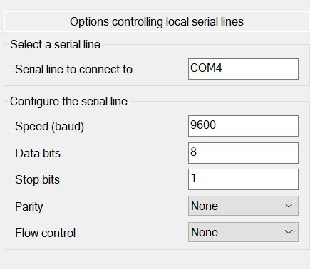

I believe this is caused by a mismatch in the baud rate, even though the LPUART1's baud rate configuration is 9600 and the PuTTY's baud rate configuration is 9600. I also matched and verified that all the parameters are the same: 8 Data bits (in PuTTY) where LPUART1 has wordlength 8 bits (including parity, although parity is 0), 1 stop bits on both PuTTY and LPUART1, no parity on both, and no flow control on both. Here is the PuTTY configuration:

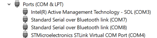

0693W000005AGruQAG.pngAnd here is a screenshot of the Device Manager showing that COM4 is connected to the board's ST-LINK. I also disconnected/reconnected the STM32 from my laptop to verify that COM4 is the port that I should be using:

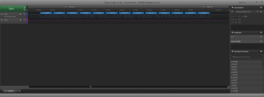

I actually have a logic analyzer with me, I scoped the LPUART1 Tx pin but I get framing error messages on my logic analyzer. I have attached a screen capture of the logic analyzer showing the UART signals when I press the blue user button to do a UART transmit:
0693W000005AOUUQA4.pngWhen there is no framing error (on the 0xE9 and 0x27 message), when the waveform transitions to high for around a bit, the signals stay high for 90.87 microseconds, which should be too short for a 9600 baud rate (I searched somewhere that it probably should be around 104 microseconds?).

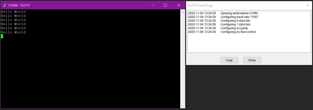

I decided to try adjusting the PuTTY terminal's baud rate based on the signals on the Logic Analyzer. Using the value 90.85 microseconds (one bit's high full duration on the previous image) to get a baud rate of 11007, and then using that value for the PuTTY terminal seemed to work for me. I do get the Hello World messages on my terminal now.
So, for some reason, even though the LPUART1's baud rate configuration is 9600, it drifted by around 14.65% to 11007. Could the clock source cause this kind of problem? Is there a certain range of bus clock speeds (APB1 clock speed in my case) that I should configure for the LPUART1? My APB1 divider is set to 4, and since the HSI16 is around 16MHz, would 4MHz be too low/high for the baud rate to be accurate?
