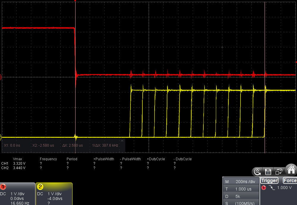

‎2020-11-03 10:52 PM
I am running STM32L412 on 48MHz MSI, Timer 2 is configured in One-Pulse mode to output a 2ms Pulse. This is done by setting Timer 2 in PWM mode and with a prescaler of 47, ARR = 1999 and CCR = 1, Polarity=LOW
An interrupt is generated on update Event, i.e. when the pulse goes low.
In the ISR I set a GPIO to high, then clear the interrupt flag
void TIM2_IRQHandler(void)
if(LL_TIM_IsActiveFlag_UPDATE(TIM2))
LL_GPIO_SetOutputPin(BTS_5V_GPIO_Port, BTS_5V_Pin);
LL_TIM_ClearFlag_UPDATE(TIM2);
Configuration is done with CubeIDE
Now, when observing the signals on a scope, I see that there is very unsteady interrupt latency that jitters from fairly good (750ns) to quite poor(2,6µs) and all this in quite neat 166ns intervals
I am quite new to the STM32, but this very coars jitter seem just not right to me and the total timespan would be something like over 100 clock cycles.
I have the feeling that I am missing something out on the configuration...
Up to now there is no application code running, just timers and some interrupts
Any help welcome to solve this mistery...

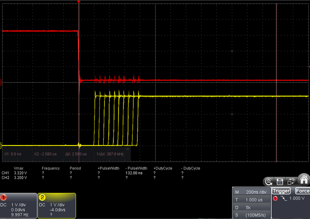

The latency is much less, but still quite a lot of jitter:
(I left the scope on the same settings to better illustrate change)
each jitter intervall is around 62ns (which would mean about 3 clock cycles on 48MHz?)
Any idea what can cause this very irregular interrupt latency?

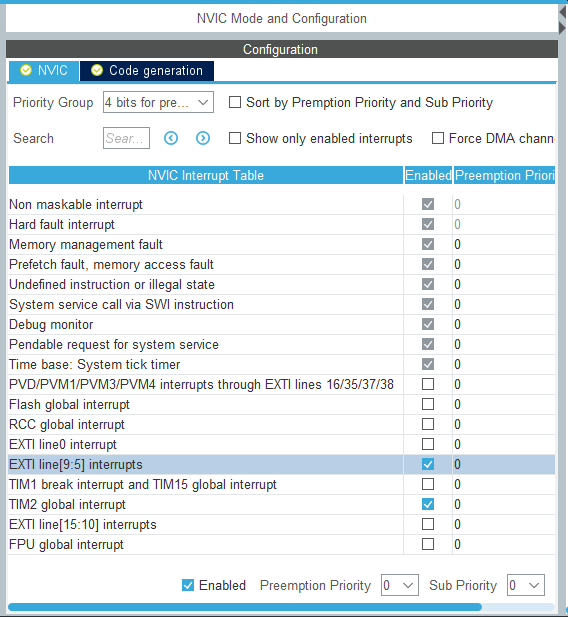

Other interrupt of same or higher priority (maybe systick if you use CubeMX autovomited code), combined with jumpcache and bus synchronization artefacts?
In 32-bitters, interrupts are a poor way of realtime control, use hardware whenever possible.
‎2020-11-04 1:01 AM
no systick, as far as I know, when using LL-libraries.
apart from system interrupts, there is only on other interrupt. Used to reset the pin that is set within TIM2_ISR when a falling edge occurs on PA5 (same pin that triggers TIM2)
BUT, when I set this interrupt to priority 1 it is never executed!
I fear, I still don't fully understand interrupt handling :(
any good uploading the project?
‎2020-11-04 11:33 AM
This definitively is not normal. Maybe the other interrupt fails to clear its interrupt source (TIM interrupt? TIMx->SR) so loops infinitely.
Toggle a (different) pin in each ISR upon entry and exit and observe.
