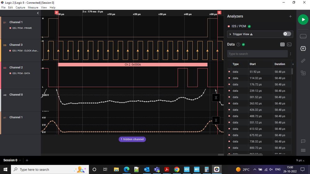

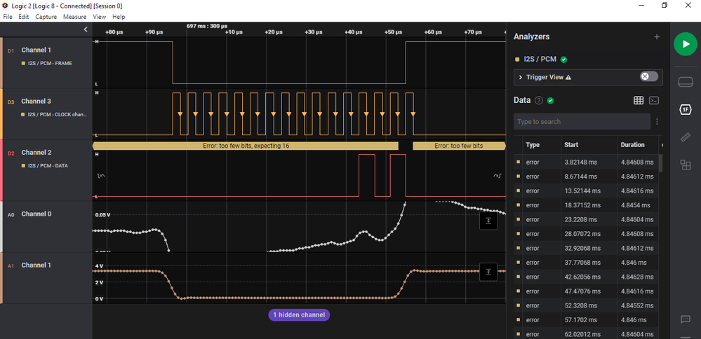

This is what I am receiving on the logic analyzer and could not relate it to waveform of the stm32f746 reference manual and I am not understanding how WS is behaving
Hello there was error in the setting of the logic analyzer attaching the new screenshot where I am getting exactly what I am sending
waclawek.jan
So, you don't see any data doubling in the signal? Then the problem can be localized to the receiver.

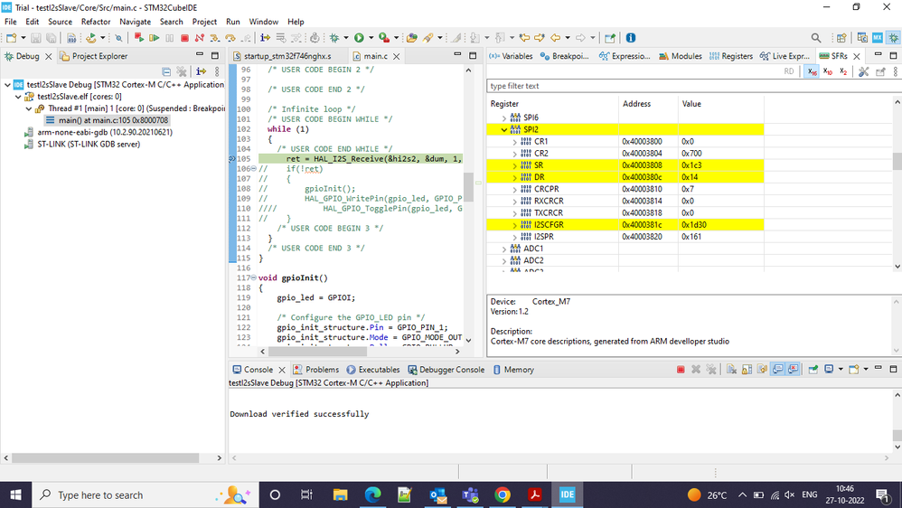

Do you use DMA? Read out and check/post content of SPI/I2S and DMA registers content.
stm32f746 discovery board as my receiver.
No I am not using DMA its just polling method.
QSHAO.1
I think you may check status registers of I2S for issue analysis, like OVR, UDR...

OK so what does "but the received data is doubled" mean exactly and how do you detect that?
