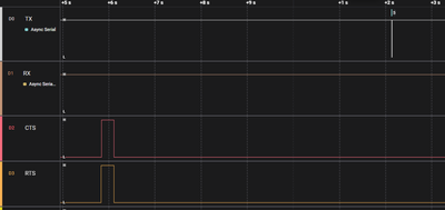

I would like to use LPUART3 to proceed the UART communication with hardware control flow enable.
However, I found that when the Send_UART_DATA  there indeed has TX signal from LA, but CTS/RTS hasn't changed, only when system reset, those two pins just could get the status changed.
Here is the configuration of MX_LPUART3_UART_Init()

I'm not seeing any issues with the signals you present.
> I was expecting there could be the status change which there is UART command be sent.
Why? There is no reason to expect this.
I don't understand the obsession with the RTS/CTS signals. If you are having functionality issues with the device, debug those directly.

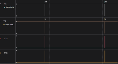

I assume that maybe the first issue need to be solve is that the RTS/CTS is not working properly.
So far, I still could not observed that there is RTS/CTS signal changed....excpet within reset
What about the RTC/CTS signals are you objecting to? Why do you think they are not working as intended?
The receiver controls RTS. A low signal indicates it's ready to receive. It's low in the plots and you are ready to receive. What's the problem?
CTS is low which indicates sending is allowed. You're sending.
Or am I missing something?

Hi @TDK ,
Yes, I also did ask about "Failed to start reception".
I am just also wondering whether the RTS/CTS control also have the issue.
I understand that when send TX data, the line could be low.
However, the issue is that even today I did not intend to send the UART command, the RTS still remain low, is this normal?
But...... it keep stay low, the pulse in beginning just caused when the system reboot....
Thanks,
CY

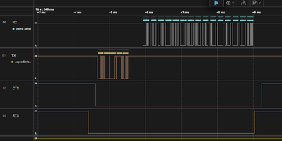

CYH
Hi @TDK ,
I just modify the code, and just could saw the RTS/CTS signal change when sending TX data as below
When it send twice, it would show like the pattern below, it seems reasonable?
But..... now it show the differnt error with UART error: 0x00000008 whenever the "Transfer completed callback" finished.

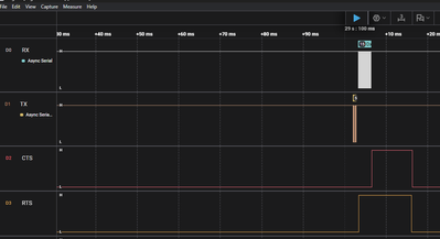

And below is the function whenever click button to send UART data
void button_pressed(void)
   uint8_t cmd_a[]={0x11, 0x22, 0x33, 0x44, 0x55};
   send_uart_command(cmd_a, sizeof(cmd_a));
   HAL_Delay(10);
   HAL_UART_Receive_IT(&hlpuart3, rx_data, sizeof(rx_data));
Do you have any suggestions to help me fix the issue?
Thanks,
CY
CYH
Hi @TDK,
Thank you for your support, after change to use DMA for RX function, the issue is sovled.
