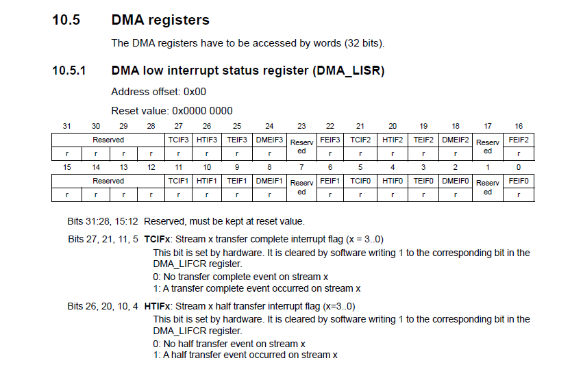

i refer DMA controller manual and stm32 f407 reference manual
  1. 4.2 DMA flag management before enabling a new transfer Before enabling a new transfer, the user must ensure that the Transfer Complete Interrupt Flag (TCIF) in DMA_LISR or DMA_HISR is cleared. As a general recommendation, it is advised to clear all flags in the DMA_LIFCR and DMA_HIFCR registers before starting a new transfer.
Then , I set TCIF3(bit 27 ) to 1 after HAL_SPI_RxCpltCallback . But It worked only one time, the second dma receive did not perform. Did i miss any information about SPI_DMA? :\
