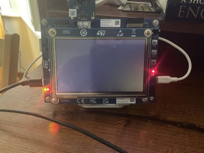

I have tried the BSP example from the STM32CubeN6 package, and the LCD works correctly. However, I am trying to create the smallest possible code to make the screen work, and I started a project from scratch using STM32CubeMX and STM32CubeIDE.
What I did was to enable the minimum amount of peripherals to make LCD work in CubeMX, and the code generator added the necessary HAL files, etc..
Then I added the discovery_lcd BSP for this board among other needed files like stm32_lcd and the fonts...
The code compiles, and the LED1 and LED2 blink as part of the while loop I coded.
However, the LCD is blank (but I can see that is active because the backlight is on). I am expecting to see a white background with some text.
You can find my code here: https://github.com/jpcano/STM32N6-digits/tree/lcd
Do you have any ideas?
JesusCano
I answer myself. The issue was that I did not configure RIF (Resource Isolation Framework) for the DMA2D and LTCD peripherals.
I added the following code right after HAL_Init(), and now the LCD works as expected. It took me a while to understand that this was the problem because there is no compilation error when using the LCD BSP as it does not depend on RIF hal at compilation time.

I called the same BSP functions and the same order that appears in the BSP example in the STM32CubeN6 MCU Firmware Package.
I tried your suggestion but I could not find the function BSP_LCD_LayerDefaultInit in the stm32n6570_dicovery_lcd.c.
At the end this is what I tried but the LCD is still blank:
  BSP_LCD_Init(0, LCD_ORIENTATION_LANDSCAPE);
  UTIL_LCD_SetFuncDriver(&LCD_Driver);
  BSP_LCD_DisplayOn(0);
  UTIL_LCD_Clear(UTIL_LCD_COLOR_WHITE);
  UTIL_LCD_SetFont(&UTIL_LCD_DEFAULT_FONT);
  UTIL_LCD_SetBackColor(UTIL_LCD_COLOR_WHITE);
  UTIL_LCD_SetTextColor(UTIL_LCD_COLOR_DARKBLUE);
  UTIL_LCD_DisplayStringAt(0, 10, (uint8_t *)"STM32N6 Discovery LCD test", CENTER_MODE);
