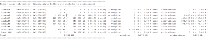

    • My colleague provided a different, more complex model from the STM32 Model Zoo(The model file is attached at the end of this post.). All earlier steps—generate, compile, download to the board—worked fine. However, during the validation step (validate --mode target), it always times out (LOAD ERROR: STM32 - read timeout), yielding no validation output.
2. Problem Analysis
Initially, I suspected this model’s weight/activation size was too large for RAM, causing the NPU to fail loading. But I later tested an even larger model (with greater weight + activation usage), and it validated successfully. Thus, “memory overflow” seems unlikely.
When comparing different models’ network_generate_report, I noticed that in the “failing” model, almost every epoch is marked as SW (software), whereas in the “successful” models, nearly all epochs are marked as HW (hardware offload). Below is an excerpt from the failing model’s epoch report (92 total epochs, 80 executed in software):

  1. Could the excessive number of SW-executed layers be causing the timeout during validation?
    • My understanding is that if a layer is marked SW, X-CUBE-AI will run that layer on the CPU, then copy intermediate activations to the NPU for subsequent HW processing. If too many layers run on SW, the pipelining is disrupted and data transfers delay the flow, leading to timeouts because the NPU never receives data in time. Is this reasoning correct?
  2. How can I push more layers to the NPU (HW) instead of SW?
    • Do I need to modify the model architecture itself (e.g., fuse certain layers, adjust quantization parameters, reorder operations) so that X-CUBE-AI’s compiler can map more operations to HW?
    • Or does ST provide any tool/configuration (e.g., in the .mpool or user_neuralart.json files) to explicitly force certain operators onto the NPU?
  3. Can I use the validate result as the definitive indicator of whether a model can run on-board?
    • If a model successfully completes validate--mode target and the reported “model output vs reference output” metrics (RMSE, MAE, accuracy, etc.) are acceptable, does that guarantee the final firmware will run correctly on the MCU + NPU with similar accuracy/performance?
    • Conversely, if validate fails or times out, does it mean the model is fundamentally un-runnable on this board/firmware combination, or are there “workarounds” to fix it?
  4. How should I edit the .mpool file—especially RAM bank assignments (AXISRAM1, AXISRAM2, npuRAM3–npuRAM6)?
    • In ST’s official example projects, some do not use AXISRAM1 or AXISRAM2 at all (all activations go to NPU SRAM banks). Others use AXISRAM2 but not AXISRAM1. Yet others distribute activations across cpuRAM2 (CPU SRAM) and npuRAMx.
    • What criteria does ST use to decide which RAM bank holds which activation buffers? If I want to manually adjust .mpool, should I base it on each layer’s memory footprint or concurrency? Is there a reference document or guidelines for this assignment?
