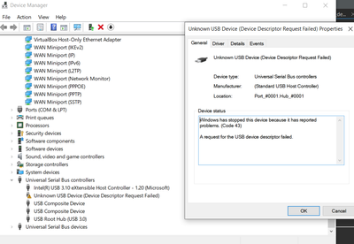

However, when I flash the code with similar configurations to the STM32U5G9J-DK1, it fails to enumerate properly. In Windows Device Manager, I get:
Windows has stopped this device because it has reported problems. (Code 43)
The USB device returned an invalid USB device descriptor.

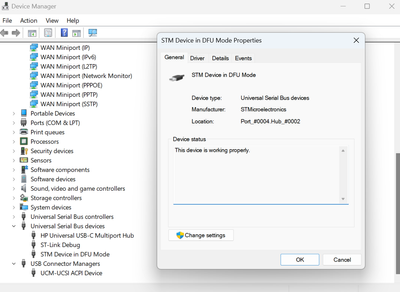

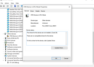

The image below shows how the DK2 device in DFU mode is recognized in Device Manager:

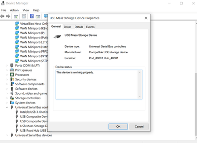

I had just changed the mode from DFU to MSC and that worked fine on the same board (DK2):
For DK1, this is what I found:
