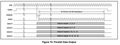

I want to build a system to sense 240 low current signals at 20kSPS at the same time using 15 ADC with 16 channels each (DDC316 by Texas Instruments, Datasheet: https://www.ti.com/lit/ds/symlink/ddc316.pdf). I intend to use something like the NUCLEO-H723ZG to drive this system.
My question is: Is it possible to use OctoSPI to connect to 8 ADCs at the same time?
As far as I can see from the datasheet the sorting of the data will be wrong since the interface expects a parallel data input but maybe I am missing a setting that allows for my use case.
A secondary option would be using multiplexed QuadSPI. Something like this seems to be intended for the ADC, as it features a 4-datalane communication mode. However, again the data sorting (page 13 on ADC datasheet) is different from all the documentation I was able to find on QuadSPI (for example RM0468 or AN5050).

The ADC does not directly suppoer OCTOSPI, however I am trying to figure out if this interface can be used to read out eight separate singele SPI channels in parallel (from eight ADCs). So for OCTOSPI this would entail using the data phase and some mode or data format (memory type?), that handles the datasorting in a way, that all ADC data is separated correctly.
Is this possible?

The ADC datasheet does not mention QuadSPI specifically. It shows the following graphic in the datasheed.
This implies a version of QuadSPI that does not parallelize all data but splits the channels to different lanes.
Is there a memory format/setting for the QSPI or OCTOSPI interface, that adheres to this data format?
From what I found the forum post on QSPI memory as well as  RM0468 section 25  this is not intended. Is this correct or am I missing some function?
