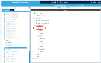

However in CUBEMX, under "USBX Mode and Configuration"->"UX Host FS"->"Host Class FS"->"MSC" is disabled.
Please confirm if USB Host Mass Storage Class is supported with U545.

Hi @NFern.1
I have already answered your question in the other post. You need to enable FileX in threadX context. If you would like to implement it in standalone context you need to enable this
#define UX_HOST_CLASS_STORAGE_NO_FILEX
However, this is not directly using CubeMX code generated. You need to configure it manually.

NFern.1
Thanks @FBL , on enabling FileX in CubeMX - the Host Class FS -> MSC option is now enabled. I should have done all the settings before posting the query, sorry for that.
I will first try to get a working U545 project with ThreadX, USBX, FileX, then I will try the standalone mode.
