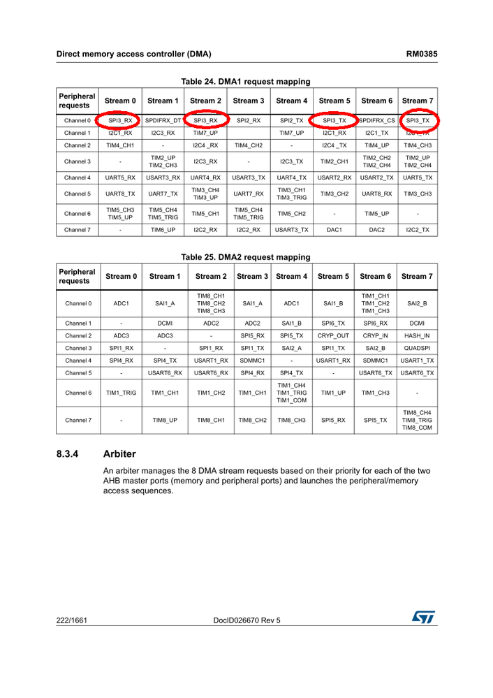

I want to receive periodically a certain number of bytes from an ADC via SPI using DMA.
Since there is no Tx line, I thought it would be correct to set the SPI at SPI_DIRECTION_2LINES_RXONLY and to program a DMA for Rx. I called this DMA with HAL_SPI_Receive_DMA(&hspi3, SplRxBuff, 33) and expected to receive 33 bytes in SplRxBuff.
My buffer actually receives the 33 bytes but the SPI generates additional clocks which I want to avoid.
In this forum I got the advice to use SPI_DIRECTION_2LINES instead of SPI_DIRECTION_2LINES_RXONLY and to add a Tx DMA even if there is no GPIO for Tx.
I tried to do this but I don't receive any data. What could be wrong?

2019-06-27 10:16 PM
You can't pull DMA channel/stream numbers out of thin air, the DMA triggers in 'F7 are hardwired and Cube/HAL can't magically reassign them.
2019-06-27 10:16 PM
2019-06-28 12:39 AM
It works! I had missed that.
