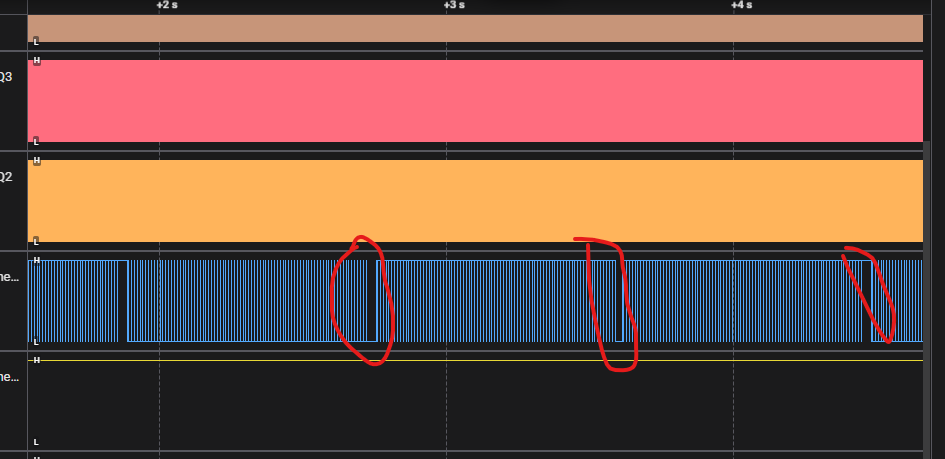

But I have two problems as follows
The DMA array size is 20 elements.
Total Transfer Time=506 µs×20=10.12 ms (as per pwm SIGNAL )
See the picture
why some red marked area is it continously  (blue is the transfer complete callbak led toggeling signal ) ?

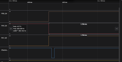

Also see the picture below
Here the blue line is the DMA complete trigger there take an 8 usecon ow to reduce it from the pwm
