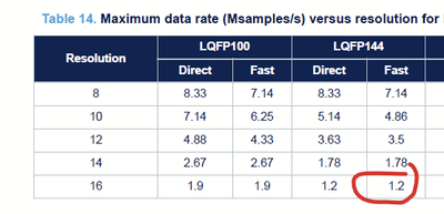

the ADC is 16 bits and running on "fast channel" so therefore should be 1.2Mhz according to AN5354

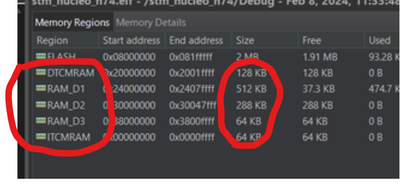

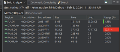

* RAM is limited and even though im supposed to have 1MB to my disposal i'm only managing to build the code for an array of about 220k half words
uint16_t adc_buffer[220000]
* now even when im using this "small" buffer when using DMA with it im only filling the first 65535 values.
and the rest are set to 0, according to the DMA Documentation im limited to 65535 requests.
You have slightly more than 1 MB available, but it's split among different non-contiguous memories. Because of this, you can't have a single buffer of 1 MB.
External memory can be added if you need more.
If you need more than 65535 values, handle the half- and full-transfer complete callbacks and transfer them to the larger buffer.
You can also use double buffer mode and change the memory addresses as things fill up.

also i just now realized that i wasn't able to use the ADC at it's full sampling speed because of the "sampling time" parameter which was set to around 800 (followed an example online)
i changed it to 1.5 cycles now and now i am sampling at 2MSPS, which is also kind of odd considering i was supposed to be limited to 1.2MSPS?
maybe i looked into the wrong documentation.
To achieve the stated accuracy in the datasheet, you should limit sampling to the rates given in that table. Nothing is preventing you from converting faster, but the accuracy will be limited. At that point you're better off using a lower resolution.
