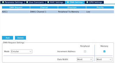

Hi, I'm using ADC1 and ADC2 of a STM32F303RE in dual regular simultaneous mode. Each ADC should sample 5 independent channels and a sampling cycle is triggered by software, so I don't use continuous mode.
I do get DMA interrupts and everything seems to work fine, except that the buffer which should contain the ADC samples which got transferred by DMA is untouched - no results transferred.

The ISR does get called and the calling stack clearly shows that DMA is called properly:
However, the result buffer which should be filled with 5 x 32 bits of data is left untouched.
Fun fact: Calling HAL_ADCEx_MultiModeGetValue(m_hadc_master) in the ISR does give me the last result.
DMA settings for ADC1 are...

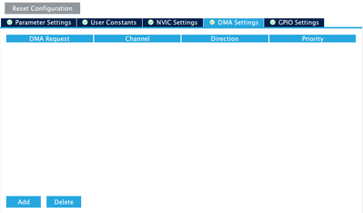

...and DMA settings for ADC2 are empty, so only one DMA channel is used:
I'm lost and the HAL documentation regarding dual regular simultaneous mode is almost non-existing. Any ideas ?

Ok, I found the reason - my ADC wrapper was not that singleton as it should be.
