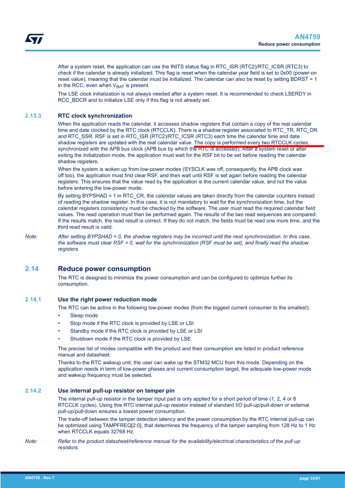

waclawek.jan
February 12, 2024
Hi @Imen.D ,
AN4759 has seen rev.8 at 08-Nov-2022, yet the line in question hasn't been corrected.
