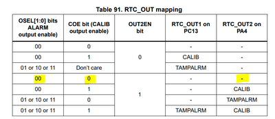

When using RTC, the GPIO pin state of PA4 may be corrupted. RM0454, section 23.3.3 says:
"In addition, it is possible to output RTC_OUT2 on PA4 pin thanks to OUT2EN bit. This
output is not available in VBAT mode. The different functions are mapped on RTC_OUT1 or on RTC_OUT2 depending on OSEL, COE and OUT2EN configuration, as show in table
Table91.
For PA4, the GPIO should be configured as an alternate function."
But, as my experience has shown, RTC_OUT2 gets to PA4 even when PA4 is in mode GPIO OUTPUT.
In addition, the RTC_CR_OUT2EN and RTC_CR_COE bits do not affect the operation of PA4 in any way. (See Table 91. RTC_OUT mapping)

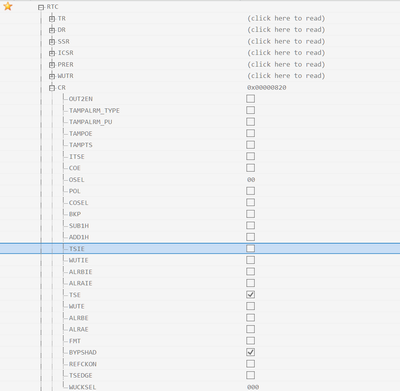

In my case, RTC->CR was initialized like this:
RTC->CR =
3 << RTC_CR_OSEL_Pos | //Output selection: 0-disabled, 1-Alarm A, 2-Alarm B, 3-Wakeup
1 << RTC_CR_WUTE_Pos | //Wakeup timer: 0-disable, 1-enable
1 << RTC_CR_BYPSHAD_Pos; //0-values taken from shadow regs; 1-Bypass the shadow regs.
The effect of RTC on PA4 operation stopped when I changed the contents of the RTC_CR_OSEL field to 00:
RTC->CR =

In this case, configuring GPIOs (PA4, PC13) as alternate functions is the same as configuring GPIO in output mode, this note in the ref man (and the Cube examples) is there so users won't configure GPIO as input or analog...
Please correct me if I'm wrong, but you're talking about this case?

For the case you indicated in yellow in the table, GPIO works correctly, PA4 is controlled by GPIOA->ODR.
Incorrect operation of GPIO PA4 is observed when the field RTC_CR_OSEL=11, RTC_CR_OUT2EN=0 and RTC_CR_COE=0.
In this case, PA4 should work as a GPIO, but in fact some signal from the RTC goes there.
At the same time, there is a strange voltage level of 1.9 volts at pin PA4. (Controller power supply is 3.3 volts.)

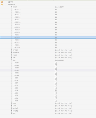

I'm experiencing an unexpected behavior with PA4 pin on STM32G030F6P6. While PA4 is properly configured as output (in GPIO mode) and ODR register is set to 1, the pin doesn't function as expected when RTC peripheral is configured.
Configuration details:
- PA4 is configured as GPIO output
- ODR register has bit 4 set to 1
- RTC CR register settings:
* RTC_CR_OSEL = 00
* RTC_CR_OUT2EN = 0
* RTC_CR_COE = 0
Current behavior:
1. On power reset, PA4 works correctly as GPIO
2. After RTC peripheral configuration (RTC_OUT2EN disabled), PA4 stops working as output
3. Pin works fine when configured as input.
Issue like this must be in errata, for sure.
Are there any workarounds to maintain PA4 GPIO output functionality while RTC is enabled?

In RM0454 is said:  In addition, it is possible to output RTC_OUT2 on PA4 pin thanks to OUT2EN bit. This output is not available in VBAT mode. The different functions are mapped on RTC_OUT1 or on RTC_OUT2 depending on OSEL, COE and OUT2EN configuration, as show in table Table 91.
So this is a feature that as stated further down requires configuring the pin as an alternative function:  For PA4, the GPIO should be configured as an alternate function.
And there is no mention of a limitation on using PA4 as an output if the RTC domain is enabled, much less as an input it works correctly.
Why then is this behavior of PA4 in accordance with the documentation?
