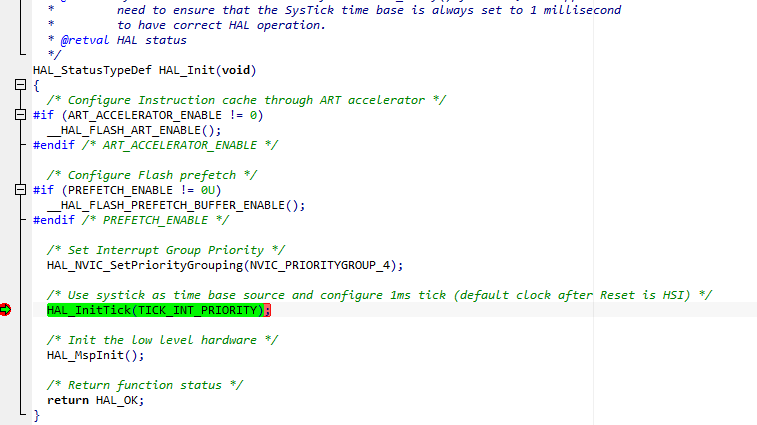

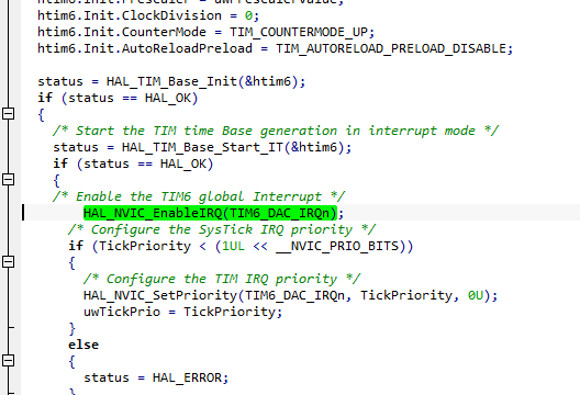

  • You can see the main code below. The code jumps unknown address from inside HAL_Init().

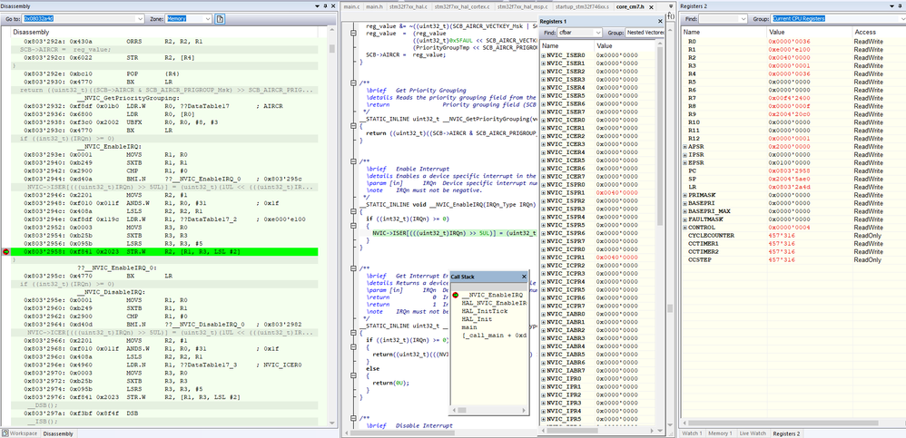

This is the main code starts as simple as possible. Here is the debug pictures:
It jumps to HAL_Init() function and then HAL_TickInit() function.

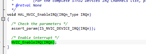

Then it goes to HAL_NVIC_EanbleIRQ function after system tick timer initialized.

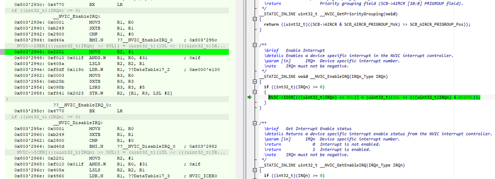

And it goes to NVIC_Enable function.

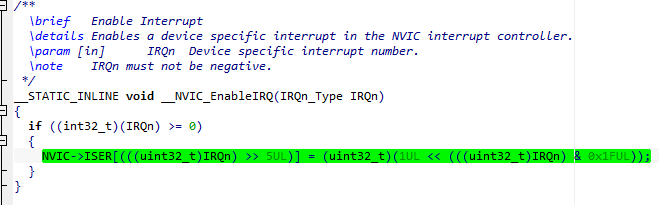

Finally it reaches NVIC->ISER[(((uint32_t)IRQn) >> 5UL)] = (uint32_t)(1UL << (((uint32_t)IRQn) & 0x1FUL));
At that moment we continue to single step on disassembly window.

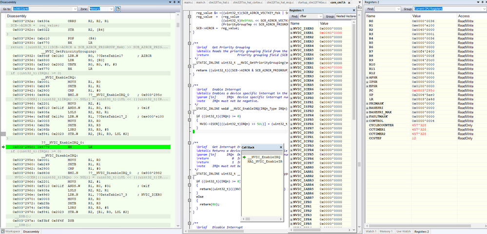

We saw everything is ok on CPU Registers
But when we go single step at "BX LR", it jumps unknown address.
Actually there was return address on LR register (0x08032a4d) and we were hopping to jump this address in LR, but it jumps unknown address. At this moment IAR fault exception viewer says "A bus fault occurred on an instruction prefetch (CFSR.IBUSERR, BFAR)...".

Hello @MuratUnal,
A first thought is timing issues related to I-Cache and D-Cache, if the caches are not properly invalidated or synchronized, the CPU fetch incorrect instructions

October 17, 2024
So likely going to the IRQ Handler, and that's trashing the stack.
Most likely the one you're enabling.
Check stack depth, auto/local variables, context switching if you're doing any of that.
Any subroutine/function that calls something else, pushes LR first, typically in the prologue, and popping PC in the epilogue.
The 0xFFFFFFF9 is a call-gate, lets the fault/handler know which stack to pull return context from.

Epamuk
EpamukBest answer
November 2, 2024
Hi I had same problem and I solved it.  I highley recommend you review the following document.
https://www.st.com/resource/en/errata_sheet/es0290-stm32f74xxx-and-stm32f75xxx-device-limitations-stmicroelectronics.pdf
Cortex M7 have some limitations. Some of theese have solutions , some doesnt,  so You have to find another way to solve problem.
Especially you have to look
CORE ->  Cortex-M7 data corruption when using Data cache configured in write-through
FMC
QUADSPI
sections.
Best luck

November 2, 2024
As RTOS probably doing a context switch via SysTick into a task structure that hasn't be initialized yet, or the wrong structure.
Check also that SCB->VTOR points to your current Vector Table. Usually set up in SystemInit () best to use a Linker symbol rather than defines so you don't have to mod multiple files.
