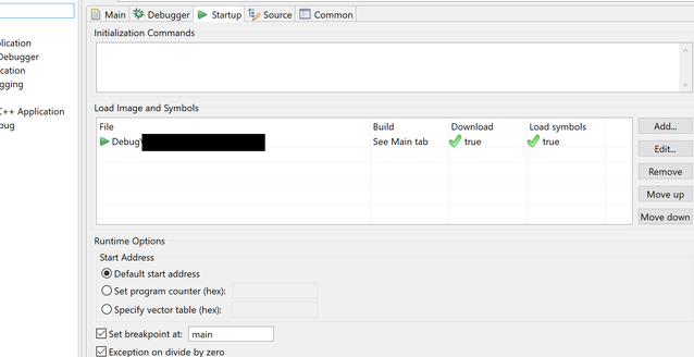

IDE or Programmer can be set to erase full or only required part of flash.
Debug can be started withoud flash erase, set it in debug config.
Trace EE_Init for error source after stored hex dump reflash...
So far not found an option how I can skip programming when start debugging in STM32CubeIDE.

In debug config set Download to false
