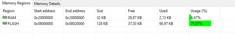

This is the memory map of my project:
0693W00000DqWOuQAN.pngI'm a bit surprised by the 71% here, it's a small simpel code project.
Do I have to configure the EEPROM emulator as starting address after 0x08020000?

Hard to say, but just be aware that blocking functions, or those dependent on delay loops using systick, should not be used under interrupt context, this includes HAL callbacks into your own code, and functions they might in turn call or depend on.
Might be time to learn how the Flash memory functions
You also don't want the EEPROM Emulation to be using flash sectors in the middle of your active code space. You need to park them outside, or carve a hole to accommodate them.
August 26, 2021
Seems like your code occupies part of the same flash being used for EEPROM emulation.
A reset will start with running your own code, provided BOOT0 is down, or similar. If that's not happening, perhaps it's because the EEPROM emulation erased part of it. Examining memory with STM32CubeProgrammer would confirm.

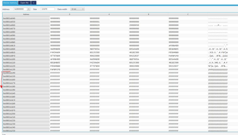

August 27, 2021
When I compile and program my project with the EEPROM package included, my Flash starts to free up space at 0x0801A140
So before my EEPROM start address was 0x08010000 and clearly overlapping.
Now I changed it to 0x0801A190 but the main code isn't running anymore.
For EEPROM emulation I need 2 pages of 2kbytes, 256 words of 64 bits
August 27, 2021
The EEPROM flash page must be located in a page not used by your code. It can't start midway through a page.
